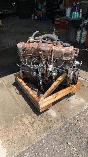

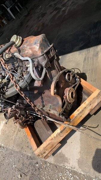

Looking for an aftermarket cam or any advice for my 1981 slant 6 ! Thx
Try contacting I Oregon Cam. IIRC they have an assortment of grinds for the hydraulic slant
Advice would need some help, what is this going in, and what are your plans for the vehicle? How are you going to drive it (strip, street, mixed use, etc)? What else are you going to do besides a cam?
Mill that head .100 and a cam swap my stock 1979 225 had a compression ratio of 7.9 milled the stock head got to 9.1 range Can't comment on what camshaft cause don't know your set up.
I read a couple of articles...want to shave the head , rebuild the engine ,port the head , 2bbl offenhauser intake with a small 2bb carb , headers and a cam...shooting 200 hp approx , but since its an hydraulic cam i dont what the streetable specs could be ! I dont want to have custom pushrods if i shave the head. // streetable car with 4 5 speed and low gears !! In my lightweight challenger, car will be around 2800-2900 pounds or less
