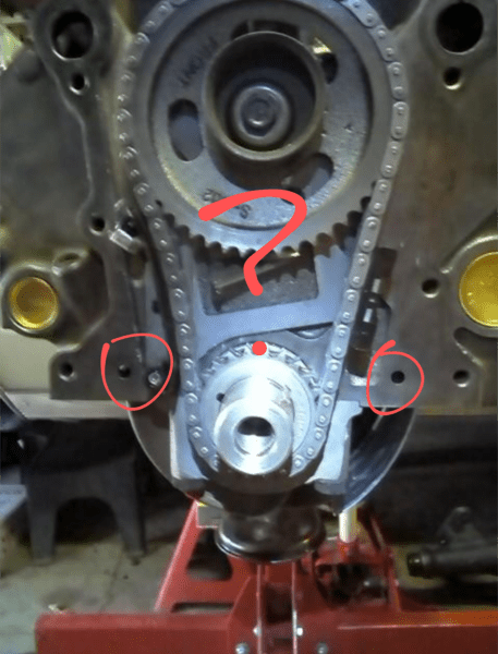

Yes, no alignment pins on our stuff. Well, the heads do.
I did the balancer bolt on my asshole brother's 65 Buick Gran Sport 401 nailhead with an automatic by clamping a set of vise grips on the flexplate, rotated against the block, and torqued to 250 ft lbs. Piece of cake. My own junk I just pound it with an impact gun and call it good.
Why not get the correct balancer installation tool? It’s so much easier than micky mousing anything. And if you ever strip a crank bolt, you’ll never use the bolt to install a balancer again.
I’ve built several and never seen any pins. I always tighten the timing cover bolts after the damper is on.
I would do the same thing. I just recall someone else pointed out the pins to me in the last few months.
I'm so confused!!!!
Found 2 photos... One that seems to show pin holes and one that does not?
I'm at a loss?????
