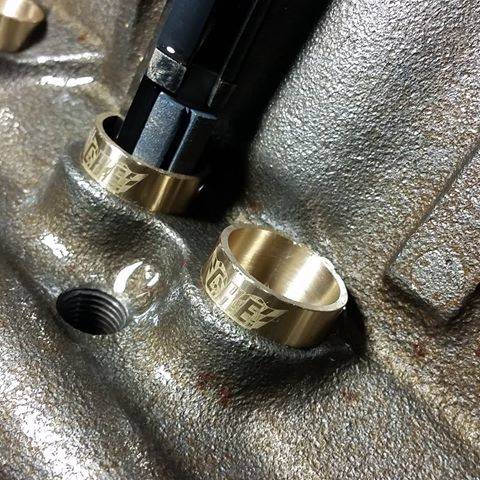

youll need to check something: Does the roller cam lift get these high enough in the bore to uncover the oil band? If so, the WONT work. Youll have some seriously low oil pressure. Common issue running rollers in an LA that doesnt have roller (tall enough) lifter bores. if so, you can bush the lifter bores to make them taller $$$

I would not risk the Chinese lifters. A friend ordered a set off eBay and his machinest told him no way. I have the Comp set you referenced and they don't uncover the lifter bores. You will need to grind down your block only for the last two in the back of the block as most castings interfere with the tie bars. Do this before any assembly then clean the block. Dan
