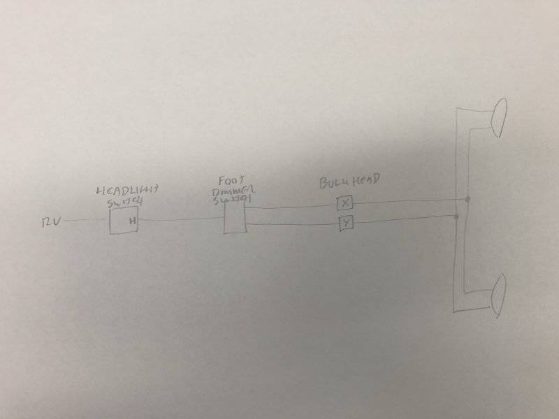

Open the Factory Service Manual to the electrical diagrams, if you do not have one GET ONE, download from MyMopar.com
Make copies of the diagrams so you can mark them up
Highlight the circuit(s) in question
I like to make a single line that I can add notes to as I troubleshoot.
As you can see this is a VERY SIMPLE circuit. The power comes from the headlight switch and goes to the foot dimmer switch where it goes to both the high AND low beams. So if you have one and not the other this is the ONLY place that the problem can be, unless someone has added relays to them.
YOU need to get your hands dirty and start tracing wires from the bulkhead to the bulbs.

POWER for both high and lo beams comes off the headllight switch and feeds to a terminal on the dimmer switch, which is a double throw switch. So stomping it switches the output of the headlight switch to either hi or lo. From there on separate wires, the hi and lo beam power goes THROUGH THE BULKHEAD connector, and around to the lamps. At some point (I don't know, likely the driver side headlight connector) the wire branches off to feed the other side.
There is only one ground for each side, usually tied together and connected at the radiator support
MOST LIKELY is a bad connection at the dimmer switch, a bad dimmer switch, a bad connection at the bulkhead connector, or a broken connection at the driver side headlamp
