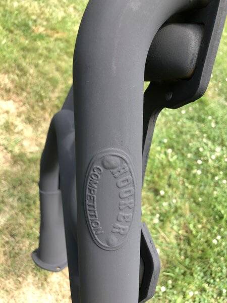

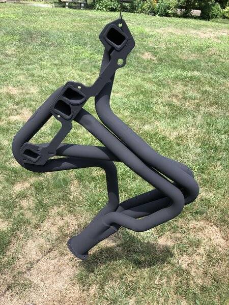

I’m not sure there is a difference between the 340 and 360, but Hooker competition headers work with a 340, 4spd and factory PS. I replaced beat up dead ones last summer on my 69 Barracuda with these.
The header hangs low and is getting some road rash again.
