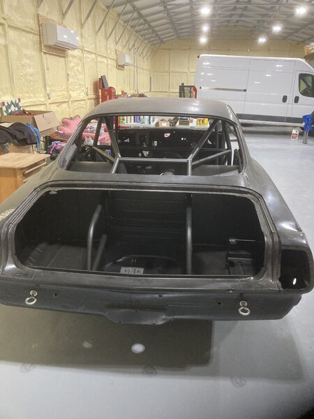

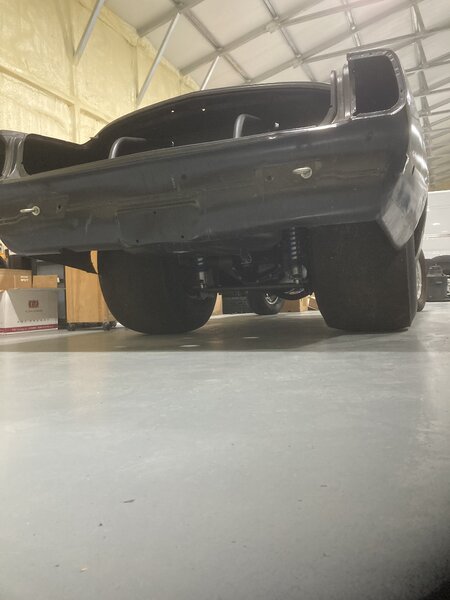

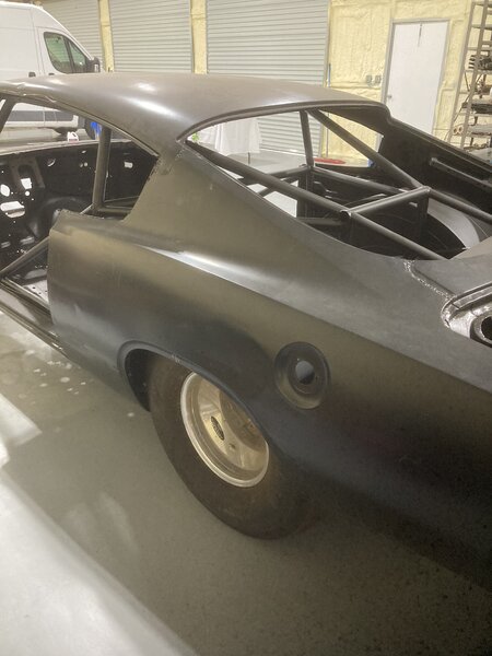

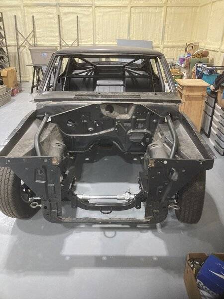

But I am putting a 572 hemi in a 68 barracuda.

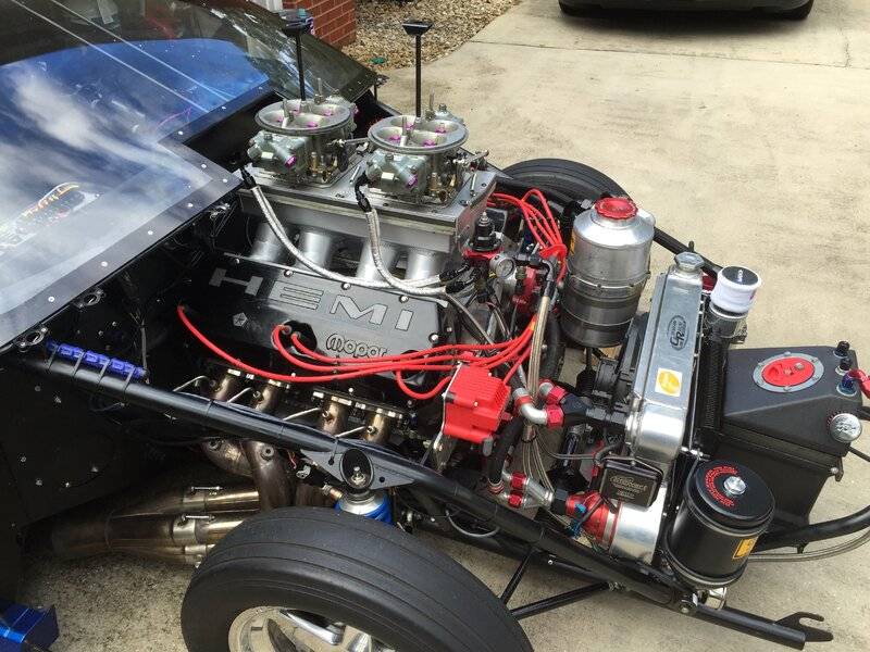

TTI carries several different Gen 2 Hemi headers.
Menu_HEMI_Headers
But I'm liking what I'm reading about, though, and hoping maybe you'll post some pictures here on the forum!

At that level, a set of custom Hedman Hussler fender well headers may be worth looking into. The custom sets I’ve seen look great, but some of the latest reviews I’ve read on them have been equally good and bad. It wouldn’t surprise me if it could make use of 2-3/8 primary tubes and 5 inch collectors. I just noticed that TTI doesn’t make any A body headers for the Indy RA heads, either, so it’s probably going to be a custom affair.

Yes it will be a street car but I am building it strong enough to take to the drag strip
I drag raced locally for 25 years
At that level you want custom made ones. if memory serves me Indy has the flange to match those heads and build off that. pricey but it will come out like and where you want it.
