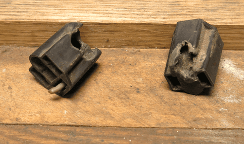

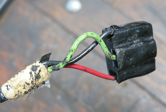

Common places to find damage are at:
the headlight sockets themselves.
the dimmer switch connector
the headlight switch connector

Some other possibilities are:
Wires chaffing against edsges of sheet metal. This can happen most easily at the back of the headlight buckets causing a short.
Ground wire issue. Ground wires for the headlamps gets screwed to the front panel the radiator mounts to.
Another thing that could be happening, along with all else, is the headlight switch CONNECTOR could be so bad on the B1 terminal (loose/ corroded) that it is heating up the terminal enough to trip the breaker

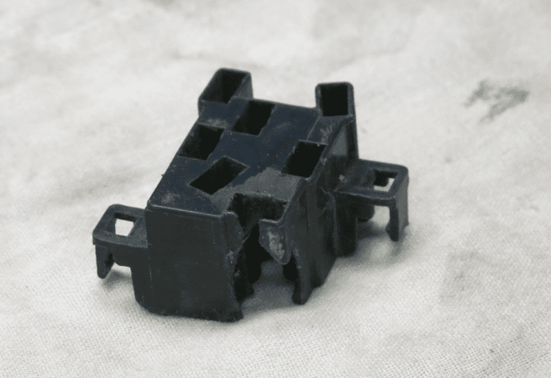

Any idea where I would be able to find a new headlight switch connecter?
I posted a request in the "Wanted" forum and got several responses from people who had used ones in good condition.
I beleive that connector was used on many cars and trucks so its pretty common even though a-body switch is slightly different (15 amp circuit breaker).
