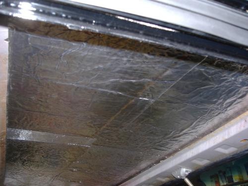

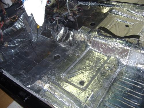

Here are a few pics of the stuff from Lowes I just installed in my Dart project. Probably not the best but works well for the money. I have used this many times in many old hot rods I have built and like the final results.
Can you post a link to what you used? Does it have adhesive on one side? If not what are you using to get it to stick to the floor? I am looking for a more cost effective material for insulating my duster
I've heard good thing about the rolls of roofing stuff you can get at home depot. Anyone use that stuff???
The stuff is great have it in my dart and w150. Under 25 for a 25' roll 6"wide. I does not have a smell from the floor above the exhaust either!
Just peel and stick, sticks better than some of the others that are made for cars. Once down it is down!
Here's some of the stuff we got at Home Depot. Used 2 rolls in Duster to cover the floor and a few pieces inside the doors. Total spend about $30-$35.
