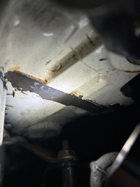

Hello,
I am helping my neighbor with his 73 scamp 318. There are no casting numbers like I am used to seeing on the rest of my small blocks. There is a 4 digit code that says 1343 next to the casting numbers.
The best I can tell the assembly stamping indicates a 1973 block built in the Mound Road assembly plant the the 10,000 calendar day isn’t making sense. I do not see any VIN stampings below the passenger side motor mount either.
Any help is appreciated.
Build sequential numbers are:
3M318R C7052308
I dunno if I've ever seen the "1343" casting before? Marine?
I’m not sure Steve. The car is a 73 and the block appears to be a 73 and there is also a pentastar cast into the side of the block. This one is strange to me, unlike anything I’ve ever seen.
Pentastar? I've never seen one on block before? Another silly question, could it be a DC block?
