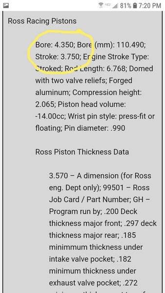

My Father had a built 440, but the shop that built it didn't keep any records and could only tell me it won't run on pump gas and will need pistons changed to do so. I found a manilla folder with the following receipts inside of it. I'm not trying to drive at 5000 RPM going 50 mph.
Can someone elaborate on the following technical information and help me determine the best way forward (or backward) with keeping this build alive? I'm no expert, but know a little about cars. Of course my father's death was unexpected, so I am not financially prepared to spend a ton of money to get this dialed in. Any and all advice is appreciated. I know a bit, but have no idea how to tell if the engine has been stroked, bored over, what it's current displacement is if it has been. I'd hope to make this a streetable car. Everything is in storage right now and the motor has never been run.

Pro Sport H-Beam, ARP Bolts (7/16”); Rod Length 6.760; Rod Journal 2.374; Wrist Pin 1.094; Big End Width 1.012​

Ross Racing Pistons
Bore: 4.350; Bore (mm): 110.490; Stroke: 3.750; Engine Stroke Type: Stroked; Rod Length: 6.768; Domed with two valve reliefs; Forged aluminum; Compression height: 2.065; Piston head volume: -14.00cc; Wrist pin style: press-fit or floating; Pin diameter: .990​
Ross Piston Thickness Data​
3.570 – A dimension (for Ross eng. Dept only); 99501 – Ross Job Card / Part Number; GH – Program run by; .200 Deck thickness major front; .297 deck thickness major rear; .185 minimmum thickness under intake valve pocket; .182 minimum thickness under exhaust valve pocket; .272 minimum thickness at top of flat top / dome / dish; .297 minimum thickness of dome at edge on plug side; .185 intake vlave pocket to top ring groove; .169 exhaust valve pocket to top ring groove; .102 side relief; .125 pin hole to side of pin boss; .785 pin engagement in pin bosses (each side)​

From my read on your specs looks like .030 over bore. Stock bore is 4.32 your's is 4.35 putting it at .030 over bore.
Stroke looks stock at 3.750
Depending on what year 440 it was, 10.5:1 was normal stock. Looks like you have some high dome pistons there raising the compression ratio somewhere around 11.5:1 maybe more like 12:1
You can lower the compression by putting the thicker aftermarket head gaskets in it. Let's say stock head gaskets are .035 ths compressed, you can put .085 ths head gaskets in giving you a difference of .050 ths, reducing compression ratio and increasing chamber volume.

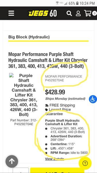

Thanks for reaching out! The guy from the shop that built it called it a "hot" cam. He said my dad was going for a mild track motor / one that would scoot down the track, but nothing that would run 9's either. He quoted it as having right at 600hp. Man, if that's true and I could stay anywhere near that and get it to pump gas, I'd be in heaven, haha! I think the cam's RPM range is going to be way too high for street driving though.
Would not be too hard to put a more street manners cam in there like the factory 440 HP cam . . Along with the higher compression it will scoot.
Just pull the front timing cover, valve covers, and intake manifold and swap out the cam with new lifters, go back to a hydraulic cam and lifters. Think there is solid lifters/cam you have in there now that you have to manually adust with a feeler gauge each valve.
Would not need the extreme pressure valve springs in there either then that go with that high lift cam, get a matching set of valve springs to go with the new hydraulic cam. Won't be stressing the valve train so much going back closer to stock, more reliability and less maintenance for a car you want to drive.
Here is the Mopar Performance replacement to the stock "440 HP" cam through Jegs, so yes they are still making them . . cam and hydraulic lifter kits.

Thanks! Do you have any input on how I could get it to be “ok” on the road? I’ve read things about putting aluminum heads on it and water/methanol kits, but I’m pretty sure if I go that route, it would require a pretty gnarly stall and rear end gears, which I don’t want. Hell, I’d want overdrive and A/C on this thing... Maybe on the A/C. Pretty sure I want overdrive though.

So all AJ can tell you is that if you install a smaller cam; the engine will immediately make more cylinder pressure. And more pressure can quickly morph into detonation. Actually in your case, it might only take a few degrees less Ica, to make it undriveable at the new pressure, cuz we have NO STARTING POINT, so we are all just best-guessing.
What we can do is recommend a nice street cam, and then generate the easy compression ratio based on various input factors... like;
Your altitude
the gas you are willing to buy
what trans,TC, and gears you want to run, and what your expectations might be for the finished combo.
In your case, you already have high compression pistons, so milling the tops off is an option.Which as already mentioned, would require a rebalance, and so between those two costs, you are close to the price of new pistons; also already mentioned.
In your case, everything is connected to everything else and there is no easy/cheap solution .............
Except maybe a whiplash/ thumpr type cam,or a variable-duration lifter, or some combination.

Thanks again for the input. If I ended up going the new pistons route, what all would that entail? Could I keep the heads, crank, valves, etc? Or do they all typically have to "go" with one another. That's the stuff I have no knowledge of. Sounds like a butterfly effect of change that needs to happen regardless of which option I go with. I guess I'll have to take it to a shop and have them run some tests on it. Maybe I should look into designing a build that would get me where I want to be, then seeing where there's manageable overlap between the two?
Thanks again for everyone's input. I had one last question. The motor is built and has oil in it. It's never been run before. How long can I let it sit on the stand without having to worry about it? I fear that I won't be able to put a motor in a car for several years, realistically..... Any advice on what to do with it in the meantime? Any service I can perform to make sure everything stays coated in oil inside?
