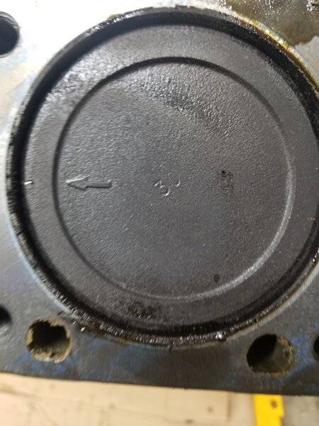

Have this 360 torn down and have a few questions.
Wondering if the pistons are stock, or stock replacements at .030 over. I ask because they all have the stamping "30" on them as pictured. I didnt get a chance to clean up the carbon in the cylinders, but managed to get a 4.02 reading on the one cylinder I measured with cheap digital calipers digging into a good layer of carbon at the top. Could these very well be replacements? They are over .100" in the hole still.

They look like .030 over stock replacement pistons to me
I second .030” over stockeroos.
The heads easy enough to look into.
Yea I can't imagine the 30 stamped in them being for anything else, but figured I would ask in case others have the same pistons in an engine of their own and can confirm that indeed that stamping suggests .030" over.

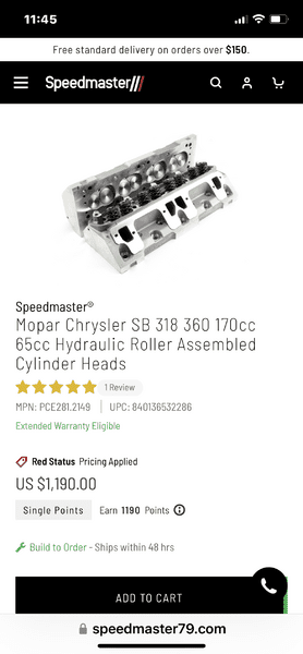

One of our members bought a set of cast iron heads from Speedmaster. He wasn’t real pleased with the flow numbers but for the price I’m betting they are way better than what you have. Maybe they will add more info if they see this.
Oh, if I go with aftermarket heads it will be aluminum. I think from what I looked at before, it would be like $700 for a set of the speedmaster aluminums setup for flat tappet (for the pair). I will only stay iron if I can find a cheaper set locally.

If you go with this set that are set up for hydraulic roller the come with nice 10 degree retainers and keepers. The springs are reportedly set up light for a 600
Lift cam which plays into the hands of many guys wanting to run smaller lift cams. If I remember right there were 4-6 shims to even lower the pressure more. The retainers were chrome moly and very nice looking. If the sale happens these were 40% off this price shipped free.
Thank you for the info! Maybe if I go for these ones, instead of the hydraulic flat tappet ones, I can run a solid flat tappet instead...but then I will have to spring for some adjustable rockers, as I don't think the factory stamped obviously can be used....Im just watching the budget fly out the window as I think right now! lol
They are a damn good deal on Black Friday though for sure. Would you be confident running these heads out of the box John?
EDIT: I see the valve springs are listed as 145 closed and 360 open for the hydraulic flat tappet. Wonder if that's enough for some solid flat tappet cams.
