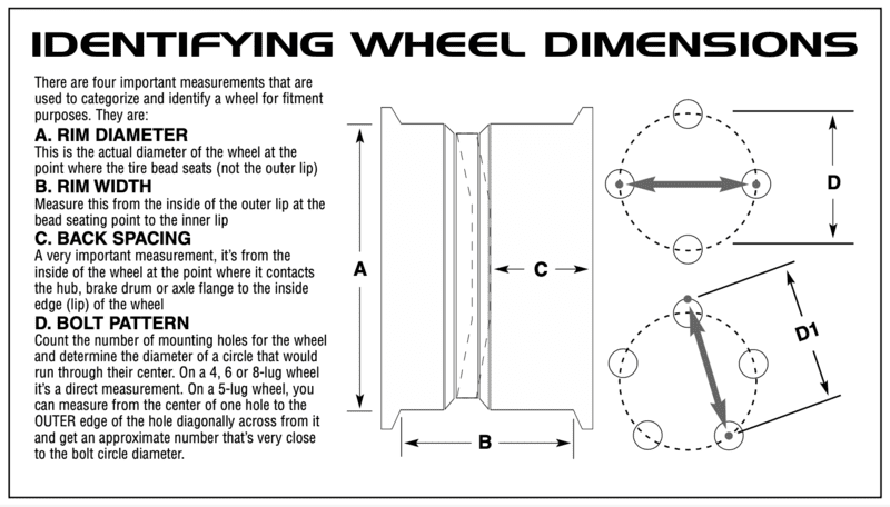

Thanks guys but here is a weird one, to me at least. I definitely have 15” rims but the tires on it currently are 195/75R14. Isn’t R14 a designation for a 14” rim?
If the sidewall says "R14" it's 14-inch and it's on a 14" rim. Tires may be rubber but they don't stretch <LOL>. Maybe you have staggered wheels (14 front, 15 back)?
I am measuring the rim lip to lip and it’s 15”. I must be measuring it wrong?
Yes that's the incorrect spot to measure. The measurement is taken from where the tire bead sits on the wheel. You have 14s.
Anyway, now that that is established, 215-70-14 would be your max size for all around. Available in T/A, Cooper Cobra and a few others. 205 or 195 would also fit... 195/70 may look a little small, 195/75 would be the non-sporting but taller version.
