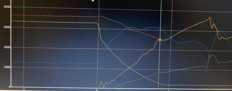

          My 'tamer customers are trending to less 1st gear. Before the 'tamer, wheelspeed launches with a 3.30 1st gear was the sweet spot for the sealed engine guys (10.1@130 3100lbs). A few years later with basically the same power and the 'tamer controlling the clutch hit, dead hook launches with a 2.93 1st gear is in favor. The drops between 1/2 in both gearsets is about the same, but on the 2/3 and 3/4 with the 2.93 set they pick up about 300rpm. Ideal for the class looks to be around 2.75, but 2.93 is the closest rules allow for the G101a.
          Here's a graph of what those dead hook 'tamer launches look like with the 2.93. Clutch is locking up about .848sec into the run, 1/2 shift is out past the 60'. Notice how far out it carries the G peak, you get a smoother hit that lasts much longer...

          They are trending down, but still much steeper than the 2.44 or 2.66 gears available to these guys.
          BTW, how much rear gear are these guys using?

          4.56 / 4.30, naturally aspirated 302ci running at 3100lbs.
