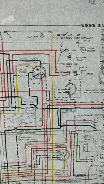

Help needed Dodge Dart 1966 wiring this is what I've done so far, can't get it cranked, put in a ez wiring loom 12 fuse in it
Michel1974
Member
Apr 6, 2024
24
17
Netherlands
Have 1 wire alternator, electric distributor, no Ignition resistor no alt regulator wired it so far so good but it will not cranck, wired relais as the Mopar diagram, does the relais ground? What could be wrong? Have a new Ignition coil, new Ignition switch, new starter....can it be that the safety neutral switch is bad? Backup lights work ok! Where does it get the positive power from?
The starter relay gets its positive power from the ignition switch and its ground through the neutral safety switch.
I have found that problem, now it won't start cranks over now, voltage at coil 10.7 v, can it be that I have to change the 2 wires to distributor?
Reversed wires to the distributor pick-up generally result in timing that's way off; check with a timing light.
Thx I try that when the engine is running, the last owner hacked in the wiring just figuring out what they did
