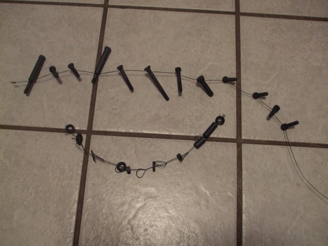

SO powder coaters to all my bolts washers spacers and all that off my wire that i had them strung to so they could do a better job
well now i have a pile of washers bolts nuts studs all that and no ideal witch one was for what i can fig out the studed shafts but all the washers and dome shaped ones are killing me
can any one send me some pics of there manifolds bolted up so i can bolt mine up lol

yes and yes problem number one
my buddy owns the powder coat shop did it the way he wanted it done but ended up not working the best so he removed them and did them on a line further apart
im not up set just want to fig out the correct way to put it on
problem number two
never had the right stuff to start with so im starting from step one
and im not new to this at all maybe darts but toy wise probley have owned over 50 projects that i have redone or built i take hundreds of photos of my tear downs and builds witch i planed on posting once i get the car back together for others to view
but when u dont have the right stuff to start u have no blue prints to fall back on
as you can see threes alot of combos i could run here so i just was asking for a few pics to get the ball rolling
i bolt a complete bolt kit and got no instructions on whats for what my biggest issue is the washers and domed washers
and yes the used ceramic on all the hot parts

conical washers, the 1/4 inch (or so) thick ones,They are cupped. Raised center goes torward the nut.
They are used on the end studs only. they are to pull down on the manifold away from the hole where there is studs. they are to suppose to stop the manifold from cracking or stud Shear when expanding and contracting. After many heat cycles the manifold will shrink.
...........All the sbm take 5/16s bolts/nuts.........the 3/8s sleeve nuts and styds r 4 a bbm...........kim...............
