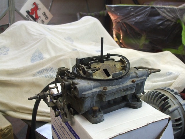

im not sure what style it is ill get a pic tonight and post it up any numbers you guys need off of it to tell the cfm

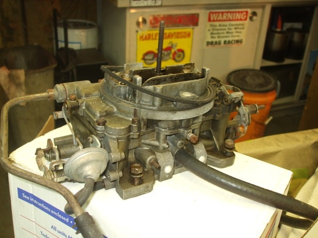

says carter avs
numbers
2
0-1921
6-1886
h7 4425s
...............its a 68 340 auto carb..........flows in the 600s, 440 carbs flowed 700s because of bigger primaries........kim.......
Kimmer is right. The old Carter tech line said the small AVS was 630 cfm, the large one was 750 cfm. I'd go with the revuild and the possible bushing of the sahfts. his is cheaper than new as said above.
