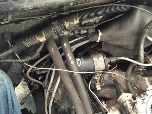

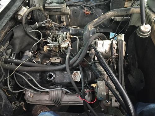

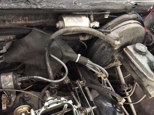

Hello everyone!
I have the same doubt. I have been looking for the manual or diagram by 3 weeks. When I thought I finally found the answer... I can't see slantsixdan's pictures where he pointed the number for each vacuum hoses...
I have a holley 2245. My Ramcharger doesn't have EGR valve and vacuum amplifier:
attachment.php
This is my engine. I'm not sure if it's 360 or 318. What do you think?
attachment.php
Here it's where I don't know how to get connected:
attachment.php
my manifold has multi-nipple: brake booster and a/c vaccum reservoir:
attachment.php
But... a/c vaccum tube go to inside and other tube return. where must it be connected. I connected it in one carburetor vaccum hoses...Is it correct?:
attachment.php
I hope you can help me... I'm sorry for my bad english O:)

The upper one (with the short piece of rubber hose on it) is a cold-idle enrichment valve used with certain emission control system configurations. You can leave it alone; it won't hurt anything to stay the way it is -- it is not a vacuum leak. The small lower one is venturi vacuum to provide a signal for the EGR system -- which you said (in your PM to me) your truck doesn't have. So, plug it.
