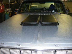

I sprayed my dual snorkel scoop with Rustoleum rattle can semi-gloss black.It turned out fine,I guess.
I went out and measured a real Sox and Martin hemi barracuda scoop placement and applied those same measurements to my hood.
My scoop is 2.5 inches from the rear of the scoop edge to the rear of the hood edge.
I am running a small block and have no issues using the measurements I got form the crossramed hemi car's scoop.
i can't seem to find a good side pic showing the scoop placement, but if it works on a crossrammed hemi and a small block in the same placement, i think you should be fine with 2.5 inches from the rear edge of the hood.

Thanks very much Cudaspaz I really didn't think it was that close to the rear of the hood, but will go with your measurements.Thanks again.
