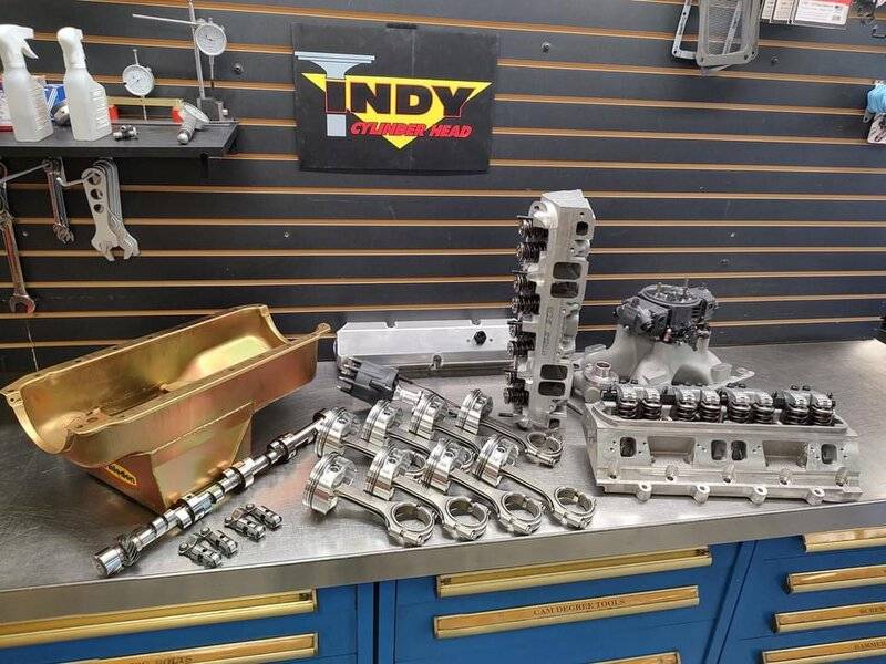

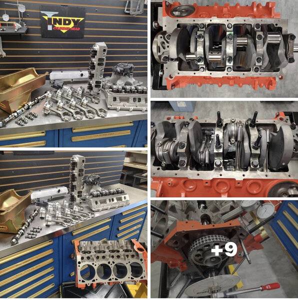

CALL THE SHOP FOR PRICING 937-708-8563--We have a new Small Block combo for sale--on our first shot this 422" small block made 730HP @ 7200 & 613 Torque @ 5700--it uses a short deck mopar perf R3 race block with 9.200 deck--4 bolt mains with 340 size--59 degree lifter angle--we have over 20 of these blocks in stock--it has 4.100 bore x 4.00 stroke-- Molnar Technologies 4.00/2.100 crank and 6.123/.927 H-beam rods-- Diamond Pistons 12.5 to 1--Indy 360-1 CNC 245 heads 2.10 x 1.650 63cc T & D Machine Products 1.6 rockers-- COMP Cams roller .740/.740--.274/.282--R106-- BAM Products Roller Lifters with .150 offset on intakes--Trend 3/8 pushrods--Indy 360-3R 1x4 w port match intake machined to fit the 9.200 block--Holley 950cfm carb--Msd dist--Melling HV oil pump-- Milodon 8qt oil pan with windage tray-- Driven Racing Oil 10w/30--730HP--613 torque--call the shop for info and pricing 937-708-8563
More pictures on Facebook
It's nice to see Indy getting back in the game with a decent combo, they've sorta been in the game the last few years hanging by a thread.

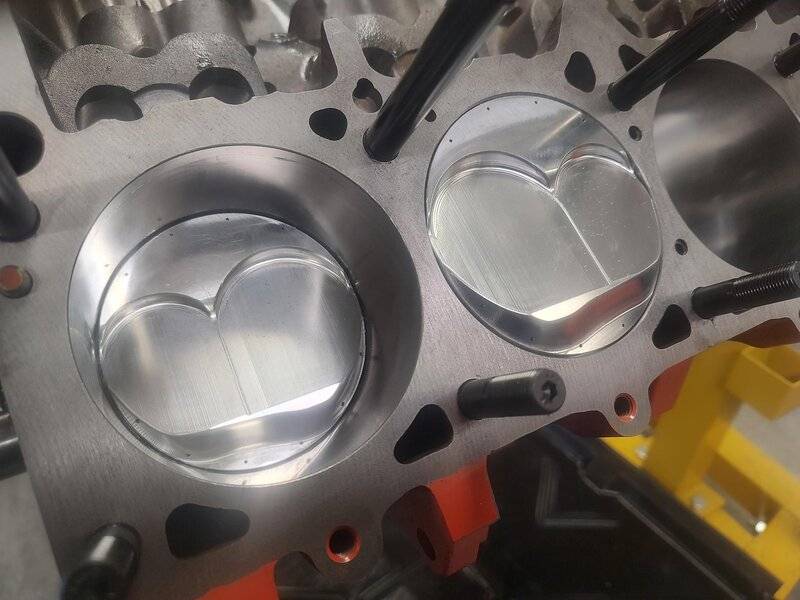

Going by the deck height and connecting rod length along with half of the stroke, wouldn't the compression height be 1.077"? I looked up Diamond Pistons and didn't find any for this combo. Are they custom made?
I would use a 3.79 type deal with that short deck, but they probably had a bunch of short deck blocks around they need to get rid of.
Yes, that results in a short custom piston. Nothing wrong with it in a race motor

almost certainly custom, yes.
Just a question, isn't that short deck height kinda short for building a stroker motor? If I did the math right the pistons would be at zero deck height and that means no room for decking of the block if it would be needed. I would want a extra .250"-.375" that would help open up the use of different compression height pistons. I do understand that this is a race car, just saying
Nothing wrong with a zero deck piston. Mine are at zero deck( flattops)
I suspect that is what the build is using. Probably somewhere around a 60cc head which would yield about 12.5 compression like stated in the build.
Yes, with a 9.200 deck you are really cramming the piston with a 4 inch stroke, but it will obviously work.
There are a few( I believe Molnar is one) that offer a 3.79 crank. Obviously won’t yield as many cubes, but imo, a better way to go. Probably still going to need a custom slug, so half dozen of one, half dozen of the other.
If I am not mistaken, think I have seen the use of a 3.79 crank even with a 9 inch deck.
Longer crank in this build won’t have to run it as many rpm’s to make power. So that is plus for a bracket deal.
