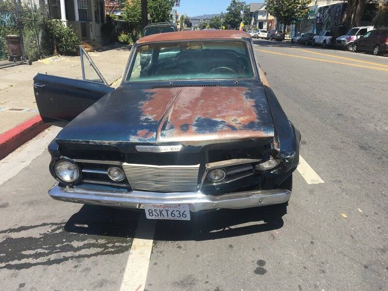

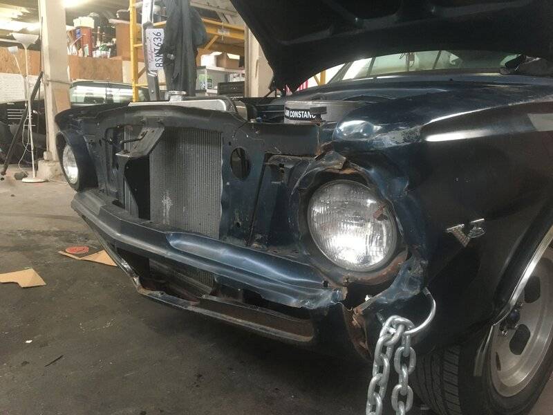

Its rough out there in the streets. Figured I’d post the repairs.
So far the damage is to fender, valence, grille center & left side, tire, bumper & left brackets, radiator, and front edge of hood.

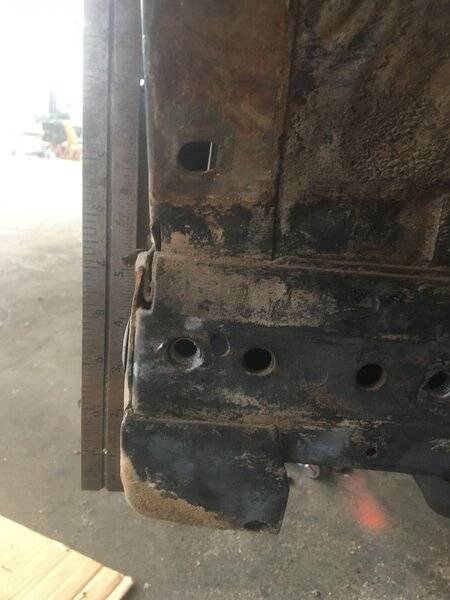

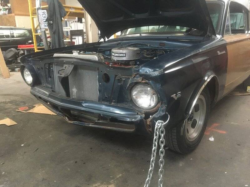

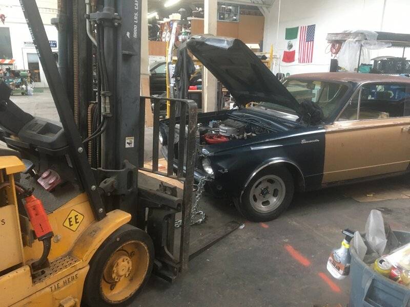

Removed bumper and pulled the damage a bit straighter with the tools at hand.
Straighter-ish. Theres a warp to the horizontal part at the front of inner fender. Radiator support looks ok so far. I hope I dont find too much more carnage.
Well this majorly sucks but progress is good. I've been known to use the forklift puller myself.

Straighter-ish. Theres a warp to the horizontal part at the front of inner fender. Radiator support looks ok so far. I hope I dont find too much more carnage. View attachment 1715737597View attachment 1715737598

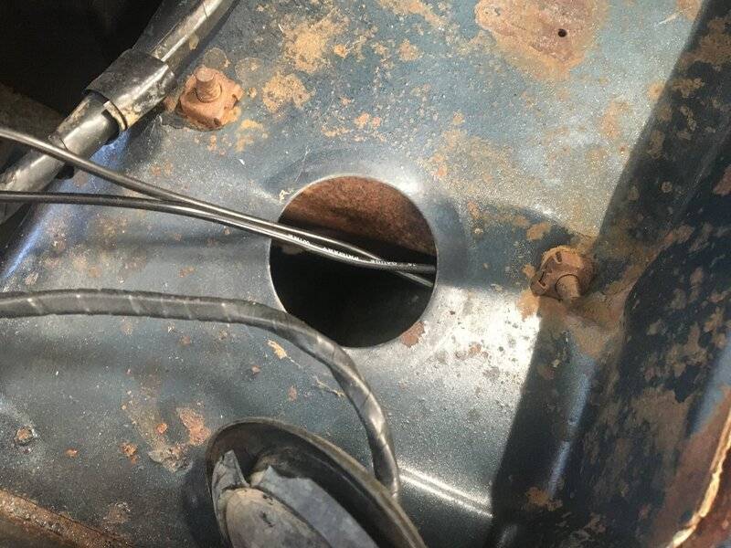

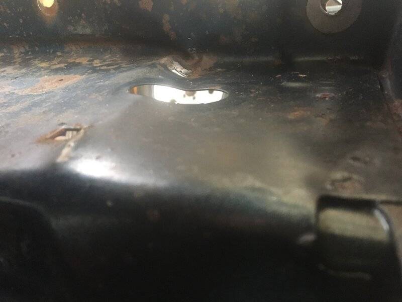

Removed the fender & valence. So much silty dust between the aft splash shield and rocker. Nothing but solid metal up in there!

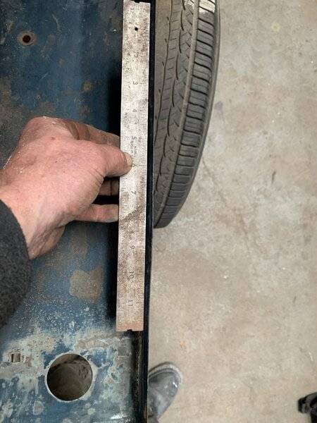

Frame section and bumper mount area are straight. The top of frame has a slight downward curve that matches tow pass side. The only new damage discovered is some smoosh to the top of inner fender and radiator support. I feel good about massaging it straight. Whew!

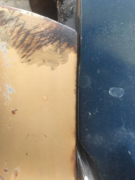

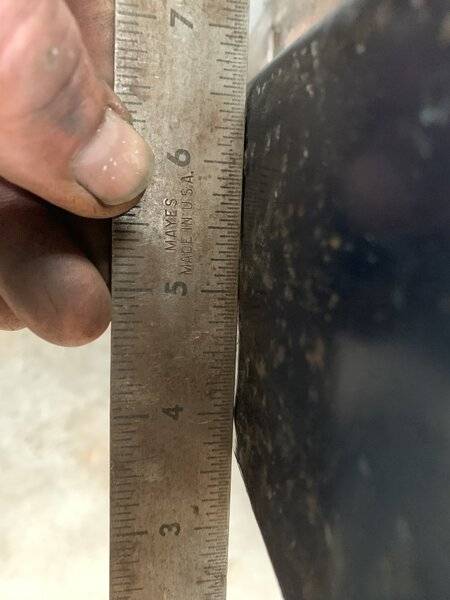

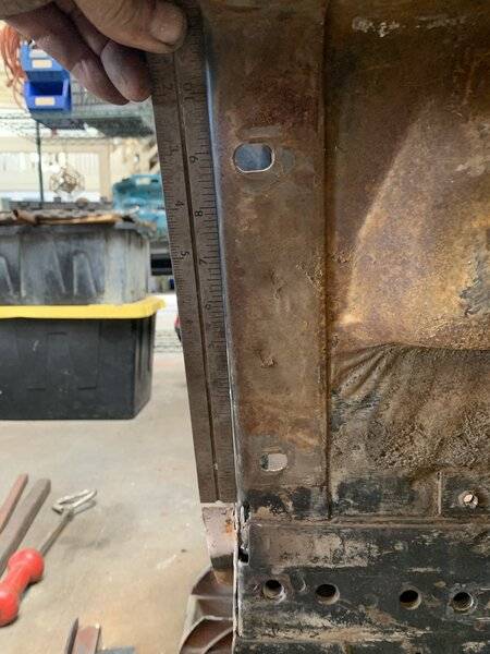

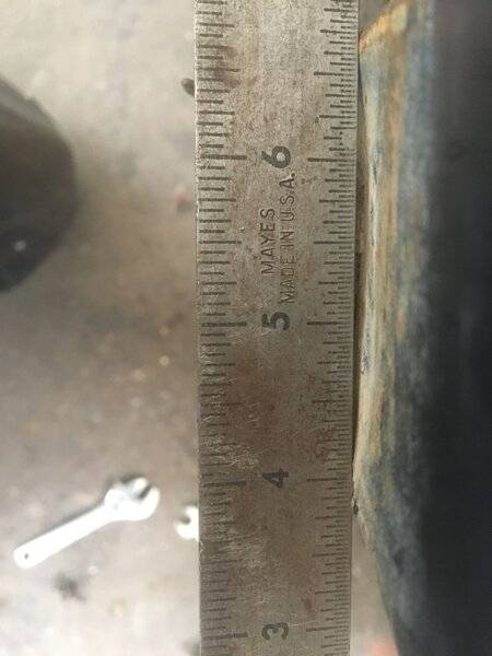

Im curious about the door-cowl gap. This predates the accident. I’ve adjusted the door outboard and this is as good as it gets. The gold door obviously isnt original, but the hinges are. I cant see any damage, but maybe the hinge pillar got pushed in? Have there ever been shims to move the hinges away from the pillar?

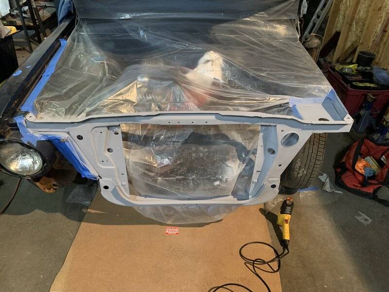

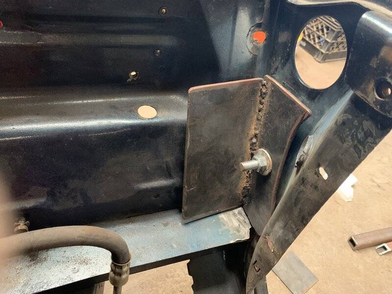

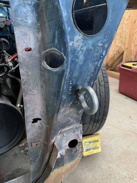

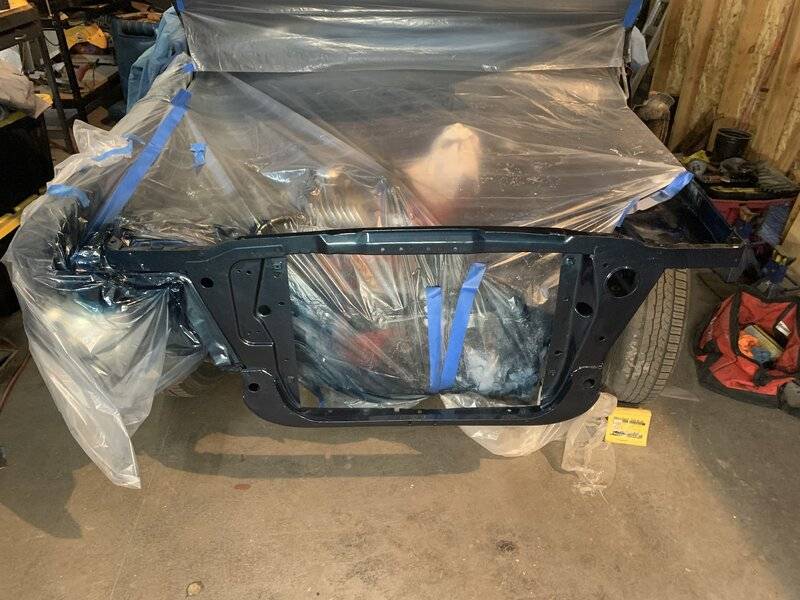

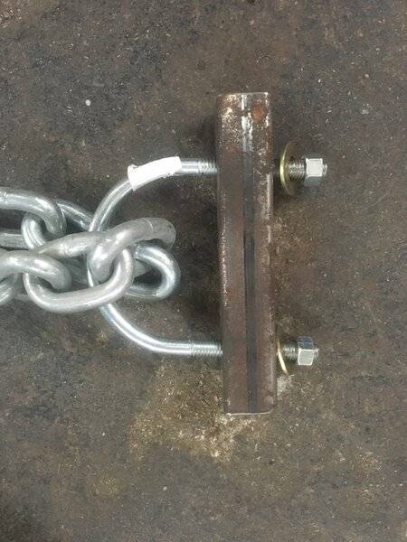

Finally getting to it. Straightened the radiator support and inner fender. I made a bracket to fit inside the radiator support to pull evenly and used the forklift fork as a dolly to iron out the wrinkle in the inner fender. Its pretty straight, but not undetectable to a sharp eye. Sanded & primed it tonight. I think I have a good match for the EE1 blue in SprayMax rattle cans.

Hosed the paint on tonight. The Spraymax was very translucent- the primer showed through until I snuck up on a final thick wet coat and it looks pretty dang ok! When it cures I can reinstall the radiator and move it around under its own power.
