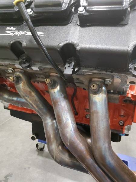

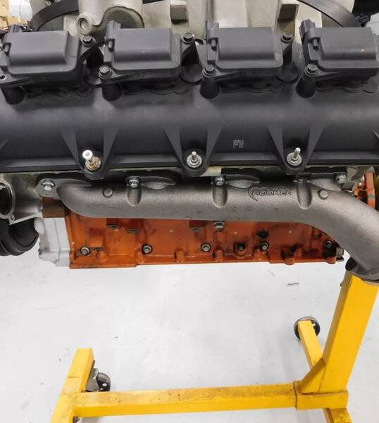

Anybody having this problem? Oil dipstick tube doesn’t fit with the manifold
Here’s some reference photos.
I got the same dipstick as the photo on top
And i got the same manifold as the photo on the bottom

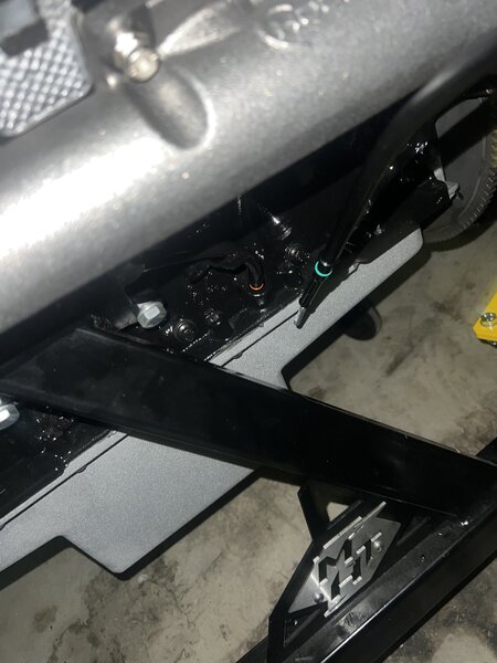

Time for some creative bending.
If you can find a piece of steel cable that fits inside the tube just about the ID you can slide it in a bend the tube.
This keep the tube from crimping.
