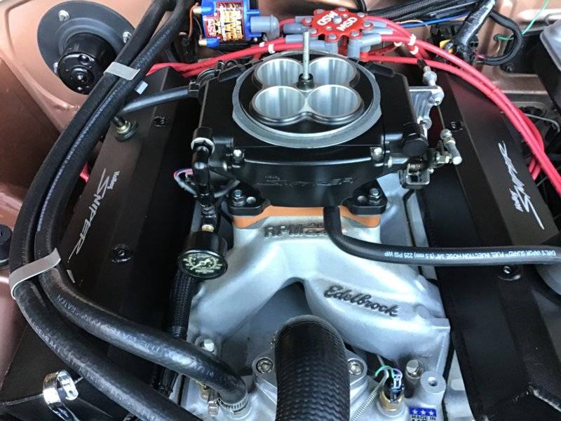

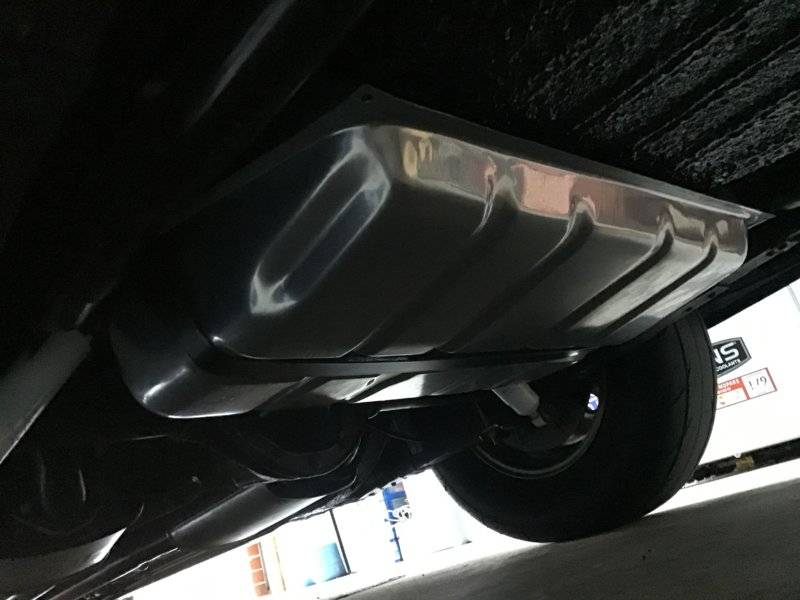

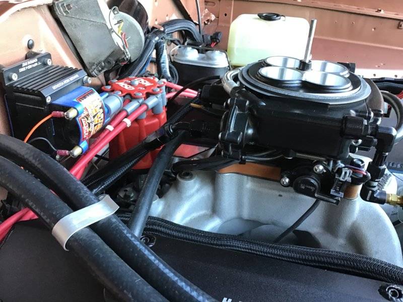

I had new 3/8 feed and return hard lines made and ran them along the frame connectors to just below half way up the fire wall than from there flexible braid fuel line to the sniper. Same with the tank pretty much similar to the factory hard lines than flexible line to the tank . That’s a tanks inc product . It’s a nice unit with built in surge tank and running the Walbro 255 pump. Sorry couldn’t get under the car to take photos of the fuel line route without raising the car.

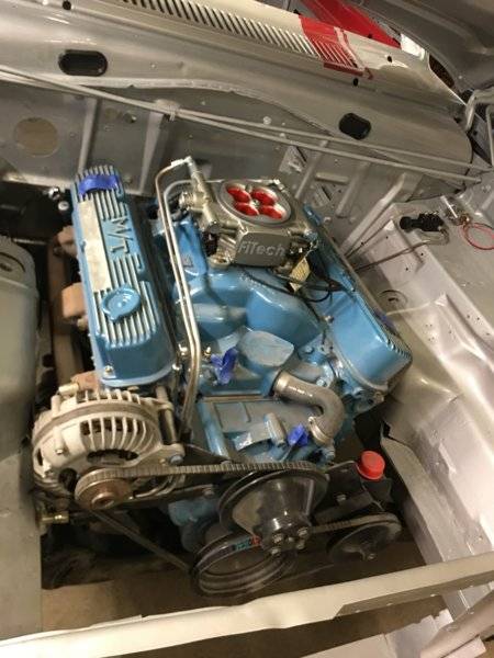

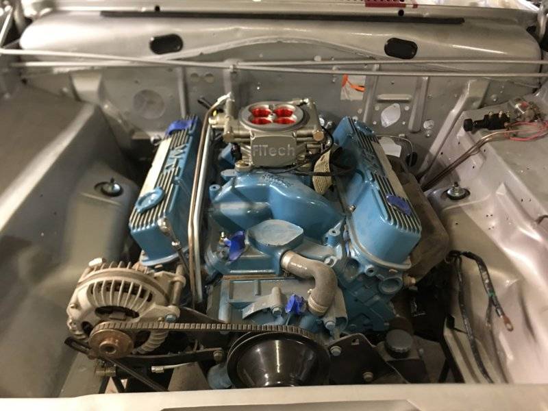

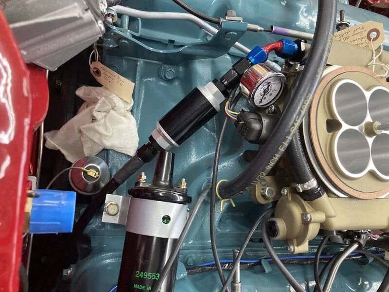

here is my recent set up. Not Holley but fitech.

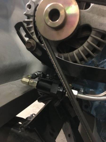

3/8” prebent stainless pressure and 5/16” prebent stainless return.
Hid the filter under the alternator. Used all factory clips on frames - had to add some. Works perfectly 600 miles so far.
side note- do not use compression fittings. flare all fuel lines and at Napa they sell a green stripe reinforced fuel injection black rubber fuel line. Don’t use plain fuel lines. They rupture easy and don’t last long with ethonol fuel.

That’s a 3/4 open spacer , I found running this that the idle smoothed out a bit but did shift the rpm up a little aswell. Reason for running the wood spacer is to eliminate as much heat away from the sniper due to the ecu being mounted at the front and there has been cases where the heat has caused malfunction in these units. Just ticking boxes to eliminate any issues. In all honesty I have been using this unit for 15 months now and it’s been faultless , instant throttle response and drivability has been great. People are using the spacer to eliminate the whistle sound they sometimes produce. You just need to adjust the iac properly.

Steel braided lines directly off the unit which connect into custom bent hard lines all the way back to the tank. I wish I took some pics when the car was up in the air, they did a really good job making it look factory. Just got the car on the road last week.

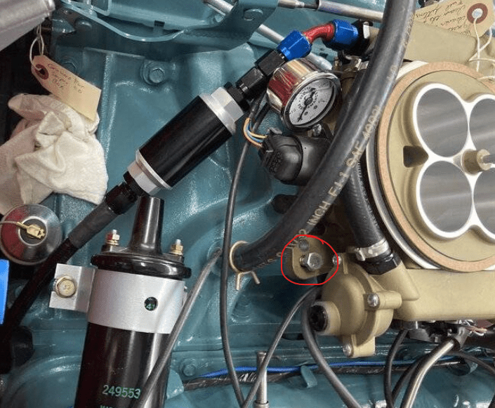

3/8” s/s fuel line run in the stock location and then -6AN fuel line hose to the filter then to the sniper. I have the Holley returnless in tank pump.
