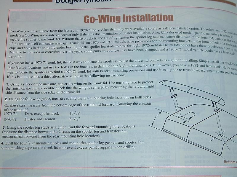

Here are some diagrams for the spoiler would love to have some for the hood pins too.
And if I remember correctly there is a company that makes stencils to cut out for the mounts on a Demon/Duster.
