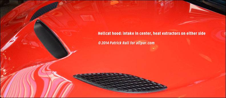

If I understand Scott657 correctly, he's looking for a way to lower under-hood pressures which allows hot air to have another exit path and it allows more fresh air to move through the radiator. Look at any modern race car and you'll see some kind of venting to accomplish this. The current crop of muscle cars are all sporting these, the C7 Vette, etc.
@scott657
One option is to get an aftermarket vent, cut a hole and mount it in place...but it has to be in the right spot to be worth your while. Basically, you'd be best off if you could find a low pressure area that also lines up with your underhood bracing.
To find this spot, you can always do the old yarn-tale trick and watch how they move as you travel at various speeds. I'm not an engineer but I believe that areas where the yarn lays flat would be lower pressure area. If anyone has a more educated understanding of this, that info would be welcome.
Found this picture on the internet machine:
