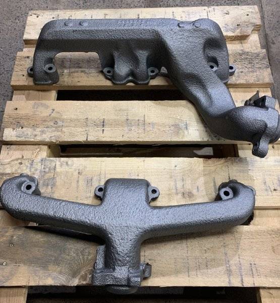

The ports are the same and the outlet diameter is about the same as later manifolds, the problem on the early A manifolds is where the dump flattens out to curl around the steering column. It looks VERY restrictive, much more than the later A manifolds. That's why some real world numbers would be interesting...
I stole this image from dgswinger's for sale ad to illustrate the bottleneck.

The ones in post #8 Mike. Vs the ones on say a 1974 318 Dart.

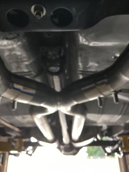

It may not be the 273 rear firing manifolds killing it, but the F'd Y-pipe they used off of them, that kinked 90 was nasty! Then you had this..and that. Although it worked pretty good for a 273. Pics courtesy of @cosgig

Yikes! Lucky for me on my 318 in an early A with the 64-66 wrap around manifolds I have a dual 2-1/2” exhaust. So the manifold is the restriction.

If that's a NOS or original HP head pipe, there were no mandrel bends back then. That design is very efficient. With that restriction it chokes the passenger side down through the pipe like the drivers side does through the manifold. LOL Even the HP 340 manifolds choke down around the steering column but not as much.

The factory HP Y is pretty efficient for a mild 273. 2 1/2" outlet to the muffler with a 2 1/4" tailpipe.
