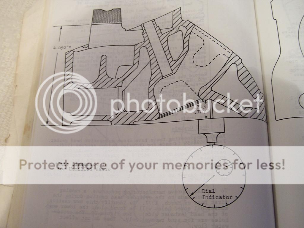

There are tooling "flats" near the spark plugs in the combustion chamber. The dimension from the block surface of the head to the flats should be .713 to .727 for unmilled heads. Measure all four and use the shortest two. Then you should be able to get close enough to figure how much has been milled.

I'm fairly sure any "as cast" surface isn't worth using as a reference point. They can vary a ton and even the surface features of cast metal can throw off a measurement enough to make a mess. I have not tested this - I tend to fit the intake "by eye" once the longblock is together - but I'm told the two machined surfaces to measure are shown in Bad's 1st picture... The surface spot faced for the last head bolt. Measure that thickness from the head gasket surface to the machined flat and it should be 1" if it's not machined. Again - with the varying casting quality, and the crazy factory machining I'm not sure that's 100% either - but I'd much prefer measuring two machined surfaces than try and make sense of any as cast surfaces.

These are the Tooling Pads used to machine the head surfaces. This is the best way to try and determine if the heads have been milled and how much they have been milled.
