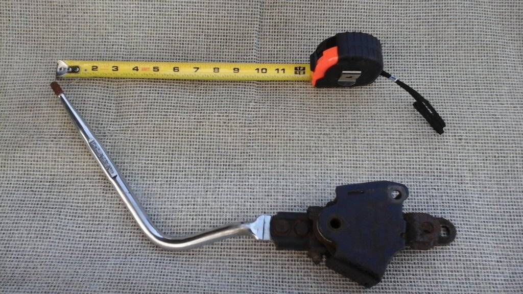

Im trying to figure out which shifter will work best on my 70 duster 4spd with buckets and manual steering( big steering wheel) i want that nice rallye look. i know at some point both 7036 and 5973 shifter sticks were factory options. Is there a difference between them? Any specs available like length and offset? Im not sure on the shift mechanism but its a 2 hole bolt on. Also is anyome selling one?.
Thanks for your help
#5973 and #7036 is the push in handle, I think your looking for the later #7926 2 hole bolt in, I think all 3 #s bends are the same, from the bottom up bends forward and to the right then bend back toward seat.
