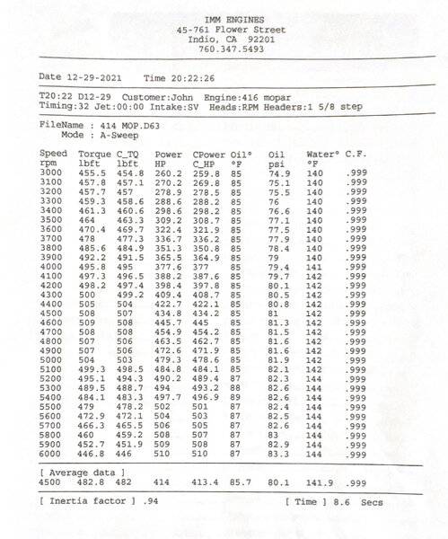

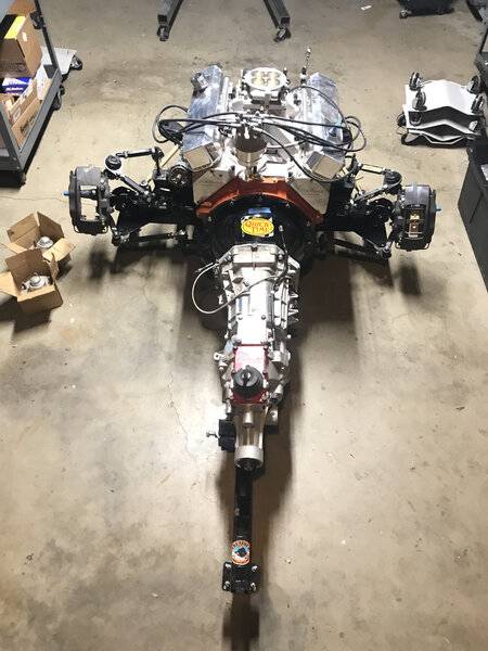

Sorry for not getting around to this sooner but I've got some specifics on the engine components.

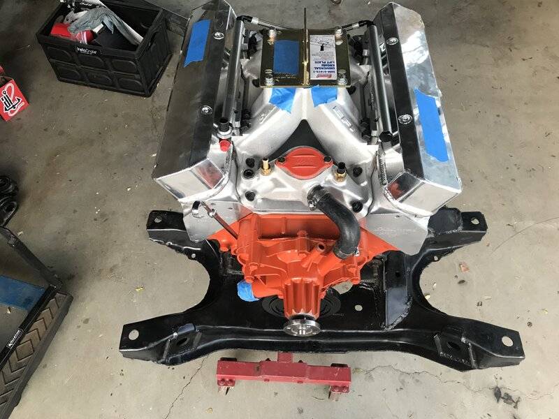

As already stated this is a 1973 340 block with a 4" crank (416"). Pistons are forged Icons. Zero deck. Piston to cyl. head clearance is .050". Compression is 10:1.
Brian pored the Edelbrock heads. The heads have 2.5" intake and 1.60" exhaust valves. He spec'ed out the camshaft and it's a custom hyd. roller from Comp Cams at 233/239 @ .050" on a 108 LSA. Lift is .626/ .635
The hyd. rollers are from Gaterman and the lifter bores have been bushed. Rocker arms are 1.6 Harland Sharps from Mancini. Manton pushrods.
Brian also ported the Melling high volume oil pump. The oil pan is the Milodon road race unit.

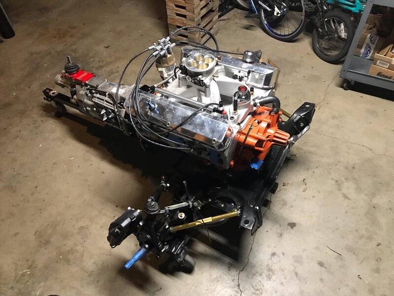

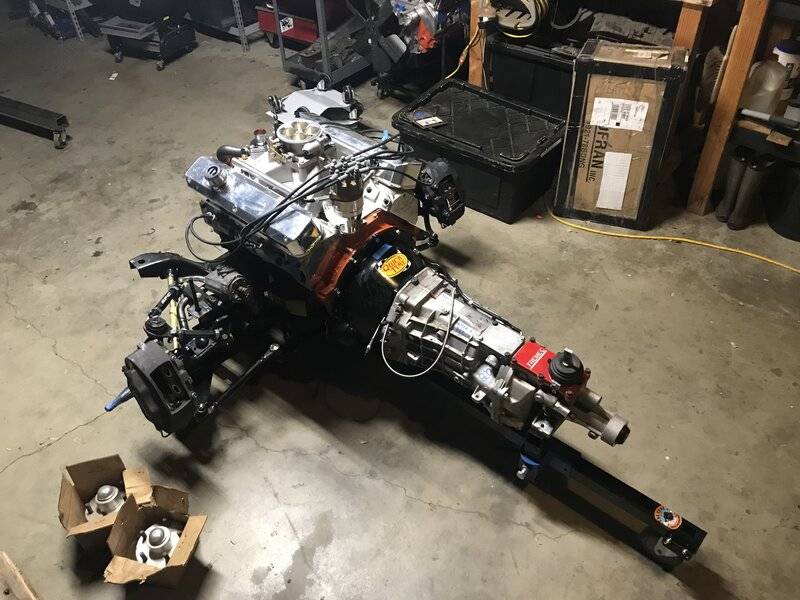

Man, I went through hell getting this engine and trans together. Tried three pilot bushings, three clutch alignment tools. The throw out bearing puts the supply and bleeder lines at an angle that doesn’t jive with the slots they are supposed to come out of on the bellhousing.
Finally got them married and sat on the US Cartool copycat drivetrain dolly.

For the engine? Yes. $12,500 to IMM but I purchased the Pro Flo efi and cylinder heads separate ($4000). The lifter bores are bushed and it took a sleeve so that added about $2500 into that cost.
Tremec trans., bellhousing, hyd. throwout bearing another $4,700. Probably another $3500+ into everything hanging off the k-frame.

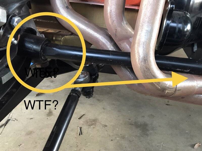

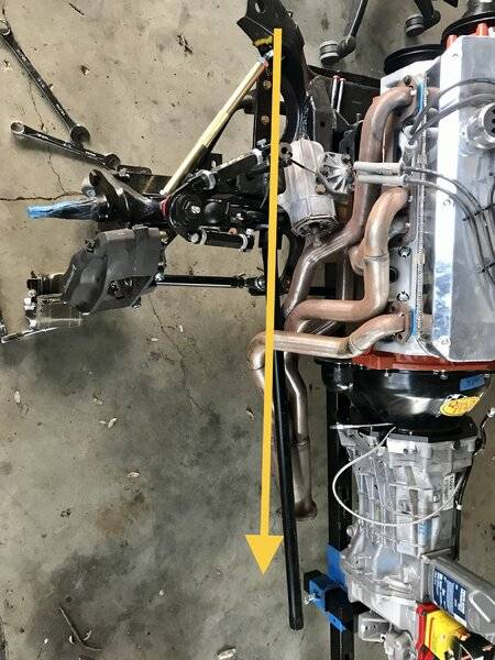

Need a hammer and heat. Maybe a cut off wheel and welder for that #7 primary.
The fitment is so bad that I think maybe these were welded up wrong in the jig.
It's not in the chassis yet. The K-member to rear trans mount position is not established. And the T56 doesn't use the factory rear mount. That might be another source of difference between stock A833 and your T56 position.
Not sure if it's going to get any better. But it very likely could change from where it's at now.
What size TTI headers are those? 1 3/4" or 1 7/8" ?
That's something to think about. Thay are the step headers, 1-5/8 to 1-3/4.
I have 1-5/8 to 1-3/4 TTI with 1.14" t-bars. That less that an 1/8" total (less that 1/16" either side)
They are very close. I'm sure one side "self clearanced".
