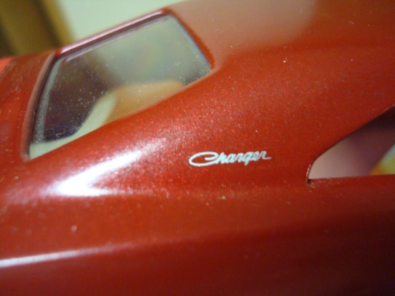

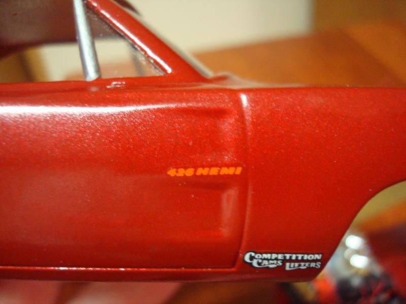

Soooo, Rani has yet another project???...I have a 1/18 71 Charger that has a little "meltage",(new word),in the same spot....
My wintertime/ I have a cold project...I work on this when Its cold and wet outside...or when I'm curled up on the couch cause I'm sick....The paint is left over from some Wheels I did from a CJ7 restoration,..supposed to be a factory Jeep colour...
Nice detail on the bird there 66340...
