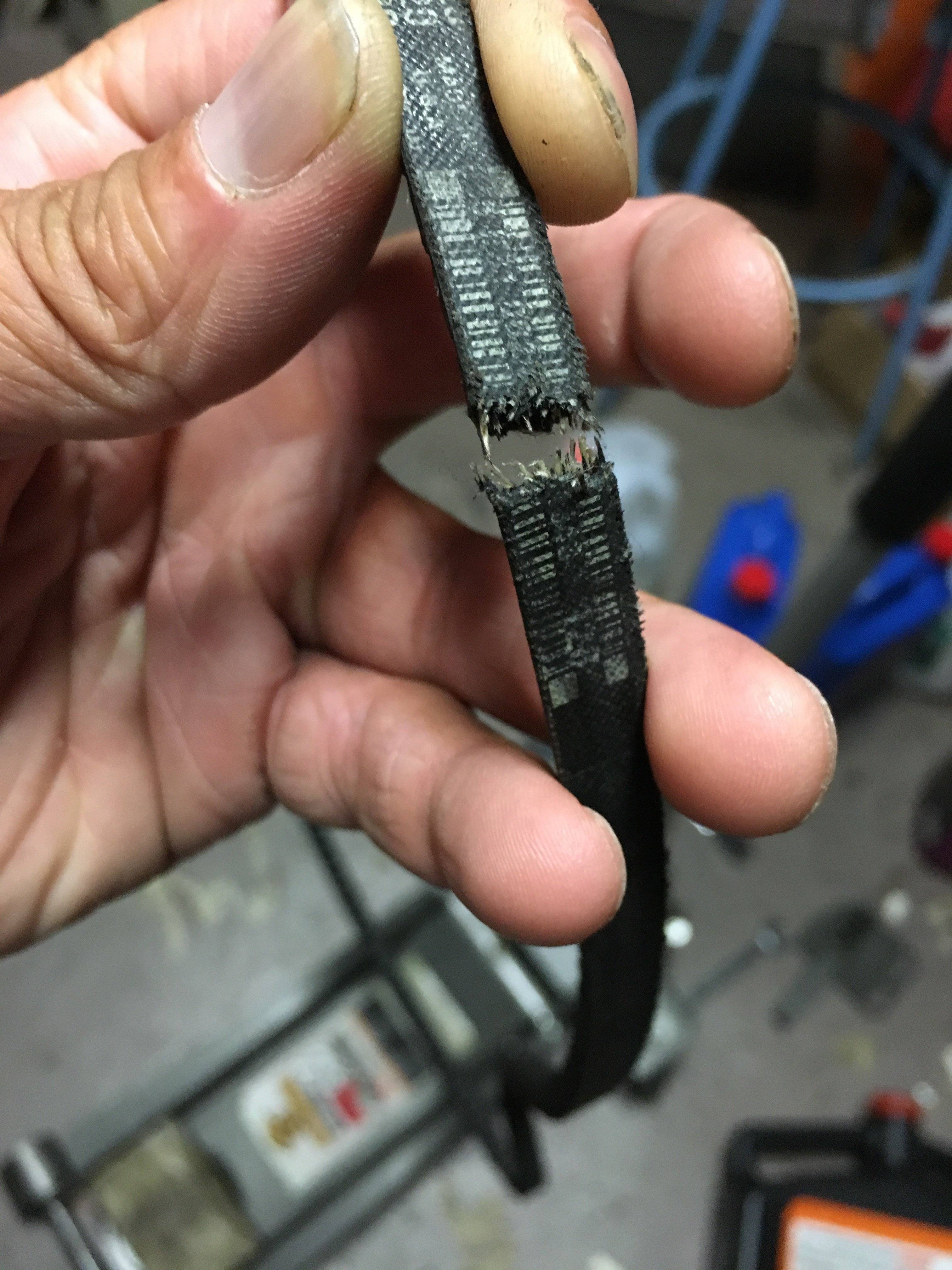

Well I've been driving the car more and more since getting it on the road.
Today after recently installing an upgraded radiator I went out for a cruise and got on it a few times. Great fun!
The last run of the day I was heading back home I opened it up again and then exited and got to the light half mile from the house. I saw my temp gauge jump from 190 to 210 then 230. The light turned green and I limped home. By the time I got there I was at 260 and puking a bit of coolant. I stop the car popped the hood and damned if I didn't see the alternator belt wrapped around the fan and the power steering belt flipped over.
I got the shop fan going and started to bring the temp down on the car. After a bit I was able to unravel the belt from the fan and realized it was broken not rolled.
It was a new belt from Advanced Auto maybe 150 miles on it.
Which brand and model are you using on your ride? This one needs to be between 48 and 49 inches.

My alignment looks good. Far as I can tell the belt just snapped

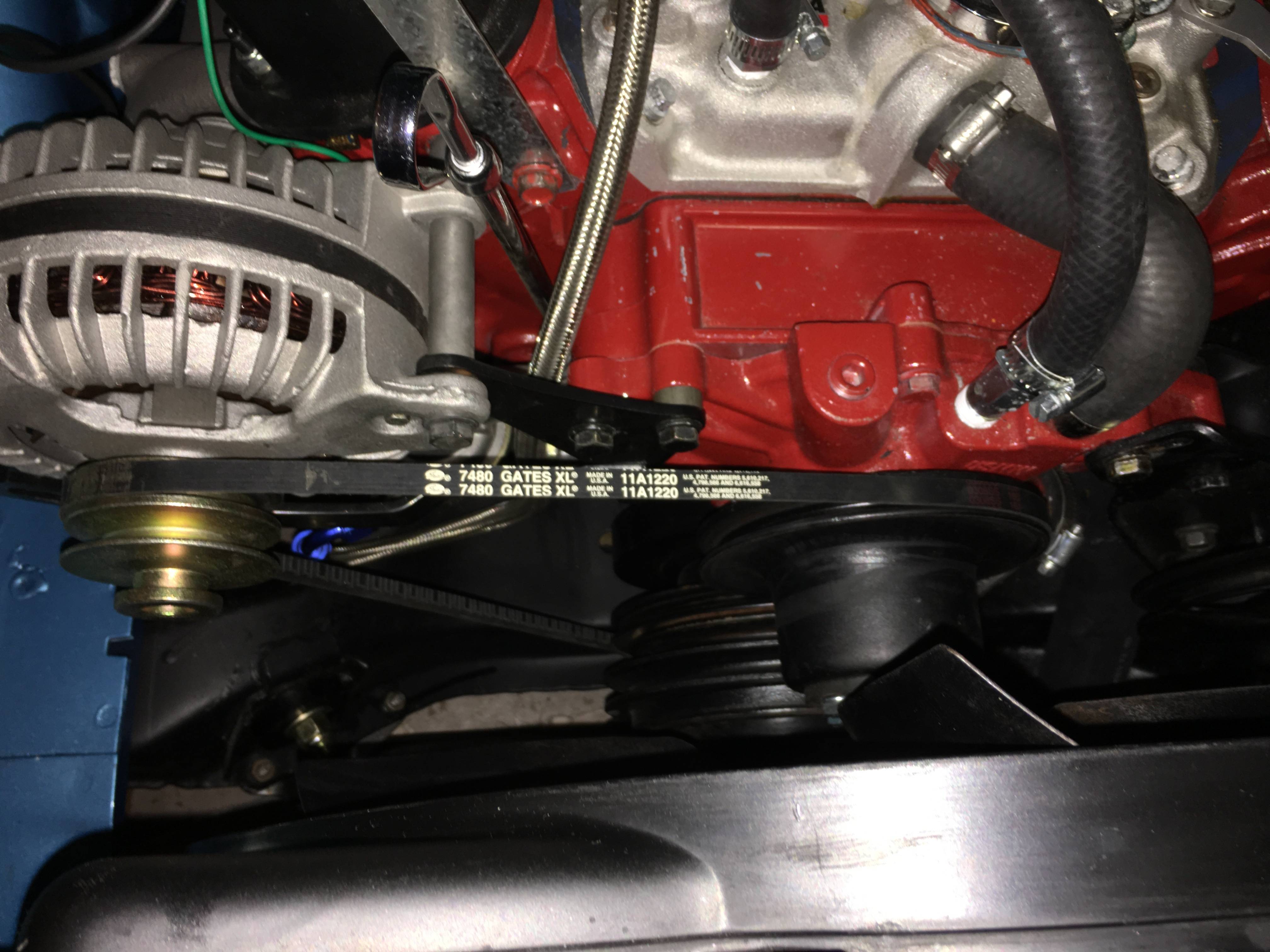

Part number of the belt? It was a gates 7480 XL. If I remember correctly I also added a washer between the sleeve bushing and the alternator bracket which stopped the vibration that I believe was causing the belt to jump at hard acceleration.

I still use the washer today and after adding it and changing the belt to gates had no problems since this posts 2016.. JINX!
