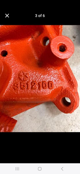

RAT ROD AL MOPAR ARCHEOLOGIST - one parts hoard at a time! FABO Gold Member Joined Jan 18, 2013 Messages 8,867 Reaction score 12,476 Location Lecanto Florida Today at 8:09 AM #1 Are these OEM 340 manifolds ?
RAT ROD AL MOPAR ARCHEOLOGIST - one parts hoard at a time! FABO Gold Member Joined Jan 18, 2013 Messages 8,867 Reaction score 12,476 Location Lecanto Florida Today at 8:11 AM #2
chrgdrt Well-Known Member Joined Nov 1, 2009 Messages 489 Reaction score 293 Location Richmond, Mi Today at 8:19 AM #3 yes on the intake, thermoquad manifold,’71
CFD244 "THE NEW OLDSMOBILES ARE IN EARLY THIS YEAR" FABO Gold Member Joined Sep 7, 2017 Messages 4,707 Reaction score 6,686 Location Northern Ontario, Canada Today at 8:24 AM #4 On my '70 exhaust manifolds, the center port is divided. Not sure about the post '70's though.
RAT ROD AL MOPAR ARCHEOLOGIST - one parts hoard at a time! FABO Gold Member Joined Jan 18, 2013 Messages 8,867 Reaction score 12,476 Location Lecanto Florida Today at 8:28 AM #5 I can't find anything on these numbers on the exhaust
moparmarks zippindippintie FABO Gold Member Joined Oct 5, 2014 Messages 3,669 Reaction score 2,423 Location Western Colorado Today at 8:38 AM #6 The 953 manifold is 273/318. 1967-72 ABC The other one is probably 73-up
Dana67Dart The parts you don't add don't cause you no trouble FABO Gold Member Joined Jul 16, 2017 Messages 16,164 Reaction score 13,543 Location Northern Colorado Today at 9:16 AM #7 Found this on the exhost.... I assume the 6 referenced is what looks like a 3 or an 8 in your photo. 4006741 exhaust manifold. 4006741 is a 72-74 318 a-body left/driver side manifold, should fit your 70 Duster but the price sounds kind of high to me for a 318 exhaust manifold, maybe if they were both 360 ones, would be nice to have a matched set on a 340
