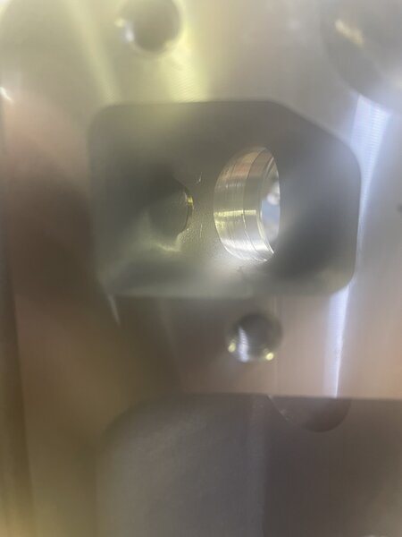

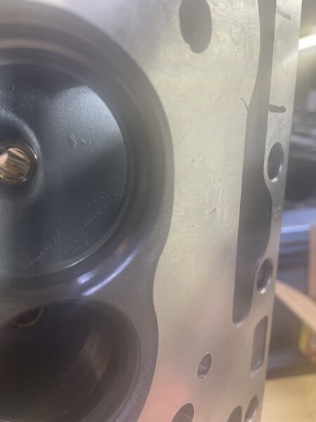

I moved on to the next person on my winter porting list and as I promised I called before I started on them. I always do this to see if they are ready financially and lay out our plan on what’s getting done. He was gracious enough to say go around him right now as he’s not in a hurry for his Speedmaster heads he had drop shipped here. He was however concerned about what condition they were in just in case warranty issues arose. So to give him peace of mind I agreed to go ahead and strip them down and check guide fit, etc. well I’m on short break after checking out the first head so here we go. I numbered everything on this head and before stripping it down now that I can I did a vacuum test. Even though I will be touching up the 2.02 valve job every port on this head passed with flying colors. Word to the wise. For some reason this head has VERY sharp edges. And I mean everywhere. Chamber, valve cover lip, deck surface. Please be careful. It actually cut the wood on my new Harbor Freight cabinet that I use for all head disassembly and assembly. Valve guides were just a touch on the lose side as always which I’ll take over tight Edelbrock guides. Throwing a Ferrea valve in the guide tightens it up that .0005 real quick. Valve seals on any head I disassemble gets replaced. Shims are 4 on some 6 on others just as before. This head as received after checking spring pressures would work well. The short turn has a little lip that would take maybe 8 minutes per head but now I’m nitpicking.

Ok guys second head vacuum checked great, guides great, chambers look very nice but will really get checked over on my porting bench at a later date. So far I’m going to say I’ve touched at least 15 sets of these heads. The only bad set was a bare set of a customer and I ate a couple hundred dollars fixing them. Bad unfinished chambers and one valve guide .003 over sized. Lesson learned for me because Speedmaster did nothing about it after a couple calls and several emails. I bought two sets but I bought them loaded. My thinking is the are hand assembled and probably go through a better quality control. For a little over 700.00 loaded I think it’s a smart move. I told you what I would do but I have the tools sitting here. Speedmaster is here to stay and are hitting all the big performance shows across the United States. Over the 3-4 years that I’ve been buying them I’ve noticed small changes for the better. Sorry the pictures aren’t better but I’m not setting these on my grubby porting table right now.
