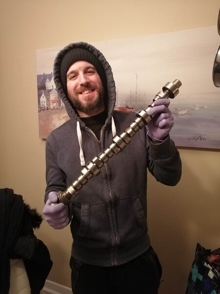

hi guys ! Since i am a dreamer and i admit it !!! Ahahahahah, i bought a 1978 440 from a motorhome , it as 40 000 miles, the engine is complete and i have a stock 360 magnum with the 380hp components, i have the roller cam from the 380hp crate and dual plane intake bla bla bla , i did the 380hp recipe with friends a couple of times and its always been great , my story is that i bought a big boat this winter : 4000 pounds 1968 fury 3 fast top with a 318 , since i would never put a big block in A bodie i was wondering if i was better off with the 440 and a a833 4 speed with 3.23s or the 380hp magnum and a 4 speed and gears in this yacht ....the 2 outputs are very very similar , but honestly i never ran a 440 and im sure that with headers and and a cam it can make some damage ! The 380hp crate is already a beast of its own and is quite surprising for such a simple combo...so 440 vs 360 magnum
