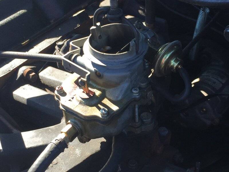

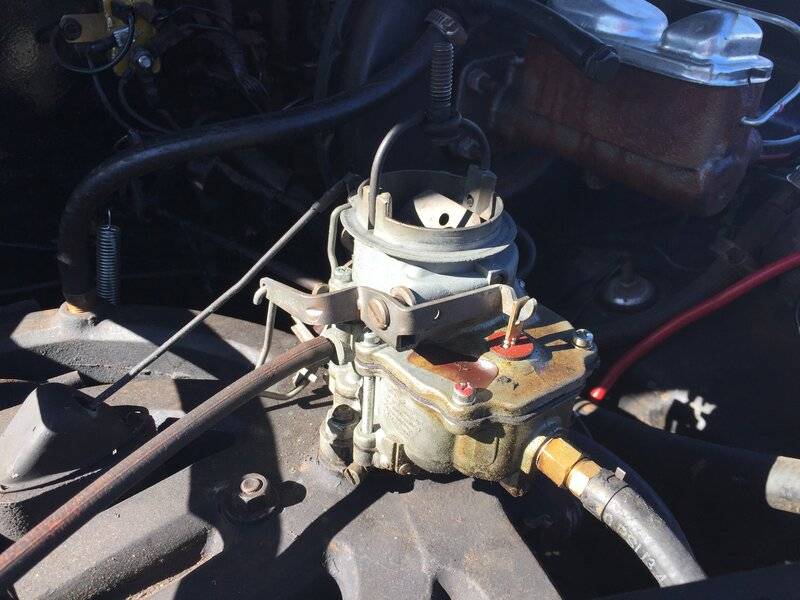

                        03FEE5B8-271A-42AB-9DE6-110DB7579594.jpeg CE4E0034-E622-45CF-9F9B-A02DDB4068F1.jpeg 41C127F0-DCEA-4CFE-BE80-37FDE81885B3.jpeg
                        Here are some photos I got of my carb. It appears to be made by Carter judging from the information cast on the side.

                        Yes, that's a Carter BBS
