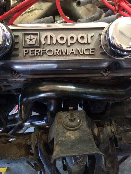

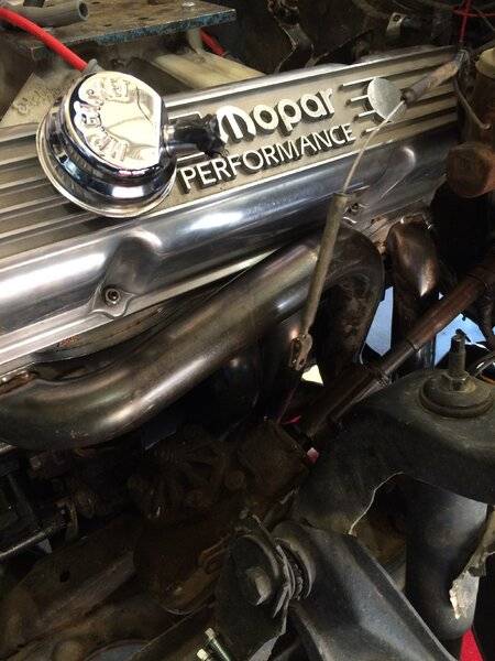

That is what we were thinking remove the rest of the fender wells. Cut weight. One thing led to another and we put a straight axle in it. We didn't like the height so we bought a 6 inch drop axle. Its a lot lighter now. Vega steering box. Bought everything through speedway motors.

Current suspension is stock other than QA1 uppers, DA Viking shocks and RMS strut rods. 73 A body spindles. Rear is Calvert split mono DA Vikings S60 Wilwood rear disc.

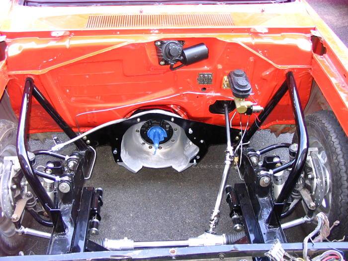

Not sure whose car this is grabbed off the internet but it paints a picture of the room you have and actually with the straight axle you have even more with the removal of the shock tower. Very lean and easy to work. It’s no fun racing with cramped engine compartments.
This is mine. I have bars that come from the cage that butt up behind the shock tower and sit on the frame rail. They are welded to the frame rail and the tower. The inner fenders were already cut out of my car when I bought it. Kim

Sorry, 8.5 chassis certified, sub frame connectors motor plate and 8 pt cage plus the J bars.. only thing is J bars are 2 piece. A pillar to firewall plate. Plate to front frame rails. If I cut out the aprons I would make solid bars from A pillars to frame rails.
