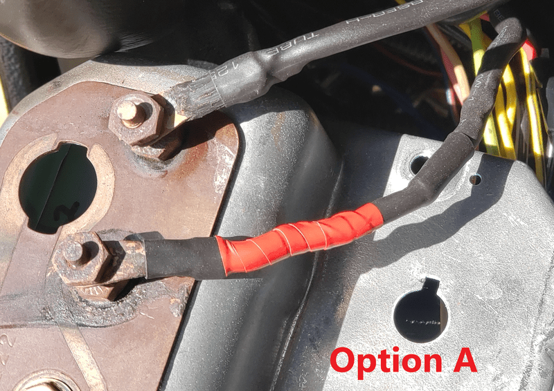

I have wired my instrument cluster, on my 74 Duster with 225 slant 6, twice already. Every time it seems everything is right and then a while later I start seeing smoke coming out of the dash. I removed the instrument cluster and the wires that are connected to the alternator gauge, by the left side, are burnt. The first time it fried my alt gauge and the circuit board. Is there a specific way to connect the wires to the alt gauge, red on right and black on left (option A)or red on left and black on right (option B)or this telling me my voltage limiter (circle) is bad and I need to replace it?

The only thing reversing the wires does is to cause the meter to read backwards. That looks mighty crusty.

The top photo is correct. If you look closely your cooked circuit board still shows the R where RED was marked. The original wire had red casing. The solder, heat shrink, red tape, and cooked board you have there shows this has been a problem before. I think at very minimum you need another amp gauge. Some of them are better built than others. The posts were swedged into a brass bar for a shunt. The resistance can be in that.
Meanwhile you could just clean those wire terminals and put them both together on just one of the gauge posts.
