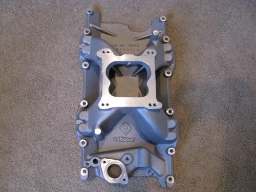

You're probably best off with one of the M1 variants made for the purpose, which leads to a question: Are you running the Magnum front accessories, or LA-style front accessories? Two dual-plane versions of the M1 were made for Magnum conversions, one for each of the aforementioned front accessories.
The Magnum-style has a right-offset water neck outlet and straight-out bypass (P5007381 - borrowed the picture and from this thread; seller gave the wrong part number in the thread, which is for the EFI air gap version: http://www.forabodiesonly.com/mopar/showthread.php?t=96551):

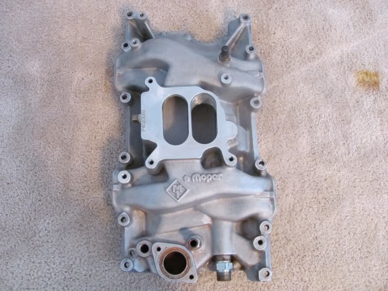

While the LA version ( P4532588 ) has a centered water outlet and has the 45 degree offset bypass:
