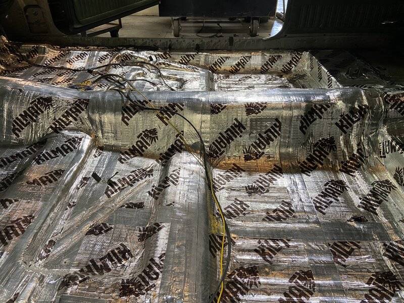

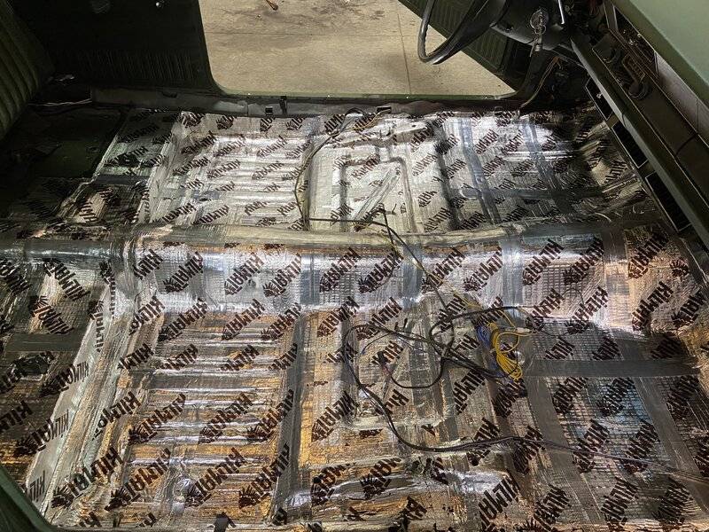

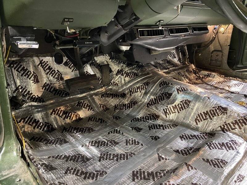

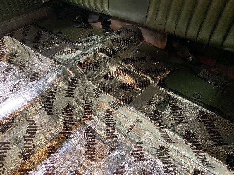

We paint mine with Rustoleum oil based industrial DTM before we put the Killmat on, so I don't see how in heck it's gonna rust.
