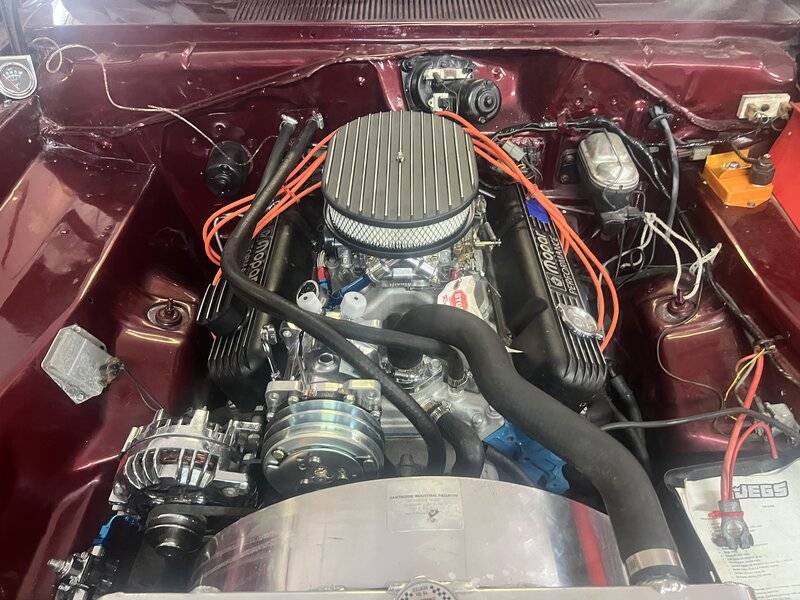

I installed a Magnum motor in my car. I was told to get an iron intermediate drive gear.
