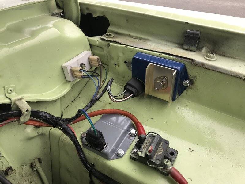

As part of my search for the problem I improved the grounding of my ECU and VR. Both are now attached with BOLTS rather than body screws with star washers between the bolt and the boxes, as well as between the boxes and the body, all metal to metal contact with grease.
