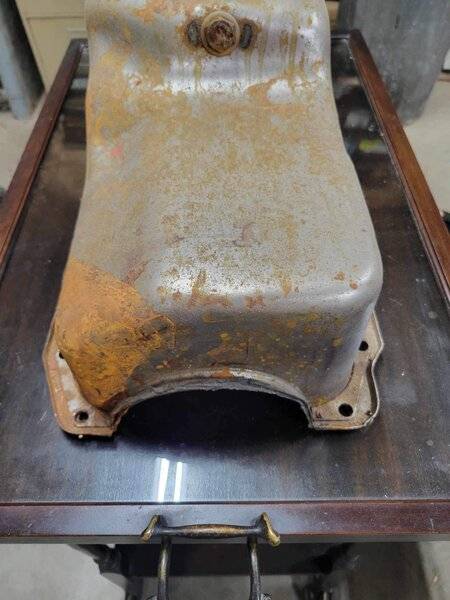

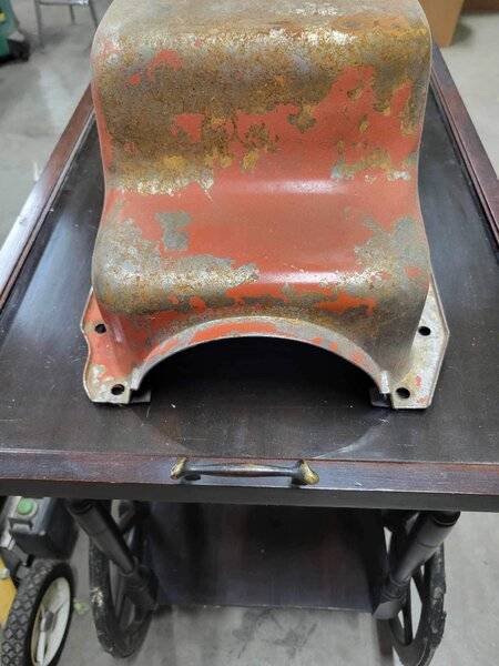

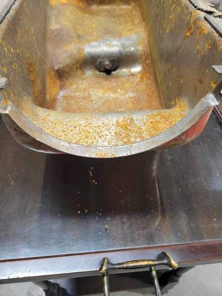

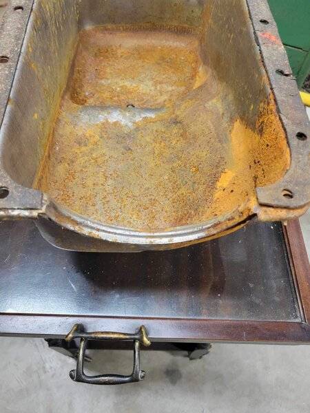

Hi guys what do you think on this pan 340 or 360?
It looks like a 360 car pan. The rear seal is area is smaller & narrower than the front. If it were a 273/318/340 pan, the rear seal would be the same as the front.
If that's an OEM pan, there should be bold 3# stamp that would provide more details (year & model use) if someone knows the numbers.

Really easy. the 273/318/340 pans, the half moon cutouts are the same size, pretty much. The 360/5.2/5.9 have a smaller cutout in the rear

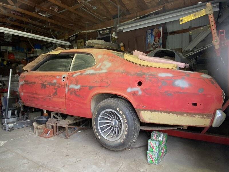

this is one of my favorite sites, I just don’t post much But here is my dart sport project.
The east way to tell a 360 pan is by the raised seam at the back of the pan as in ur 3rd pic. So u have a 360 pan. Kim
