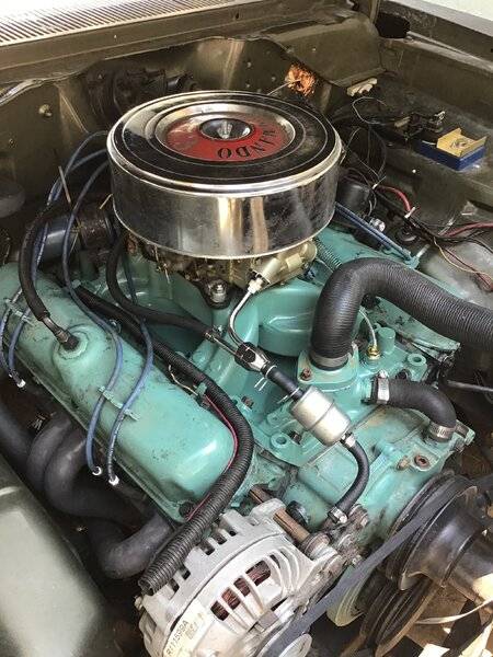

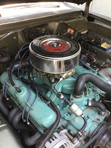

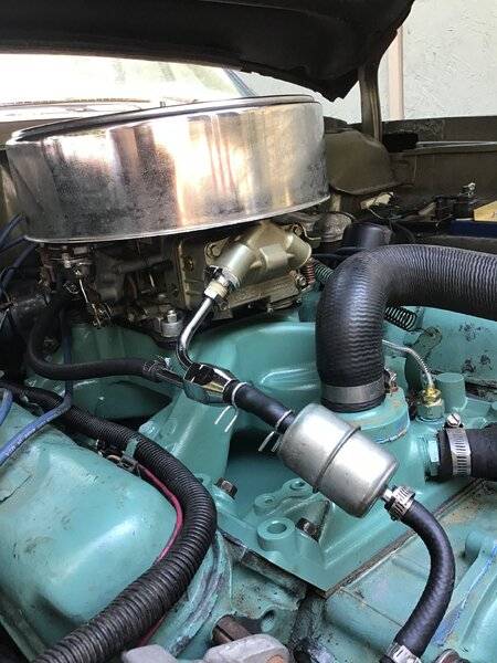

The last thread got removed because of political reasons? Lol anyways here’s the $135 Rpm Air Gap knock off I bought installed. Made a huge difference number one being the heat cross over is blocked and the carb sits above the intake, Carb is cooler and hot starts don’t happen anymore. I had the stock 68 340 intake even with the heat cross over the intake got super hot after shut off and my carb would boil.
Now for performance, I got to say is wow this thing pulls fast and quick to 6k with that Holley 750, the throttle response is excellent, the stock 340 intake felt like a rev limiter to be honest, 5500-6000 it wouldn’t pull as quick and always felt like I wasn’t pulling enough threw the carb.

It’s on a 68 barracuda, fits great even has a heat insulator gasket that raises it. Honestly you probably can make it work on an early a body, just need the right air cleaner/filter height

Duuuddeee what baseplate and air filter to make the air gap fit with the commando air cleaner?!?!?
I know that the base plate is from that small universal air cleaner they sell at o Reilly's. And I’ll check the air filter part number tomorrow for you.

in my 68 Barracuda it fit, tight but it did in-fact fit, and with a 70 aircleaner housing. Eventually I cut a hole in the hood, and sealed the hood to the airhorn, for fresh cold air, and hyup, excellent throttle response, right from idle, and seems to pull well, even to 7000+. I bought that intake when they came out, back in about 2001. It was expensive, but worth every penny; but I've never wished for another.

Part number is 42020 on the air filter and the base plate is this Mr gasket 1487
Sweet, thank you. It looks like you didn’t have to lose much filter vs stock, that filter is just under 3”.
FYI, if you ever need some more room there is a way to make a base plate using an air cleaner from a mid 90’s ram van.
