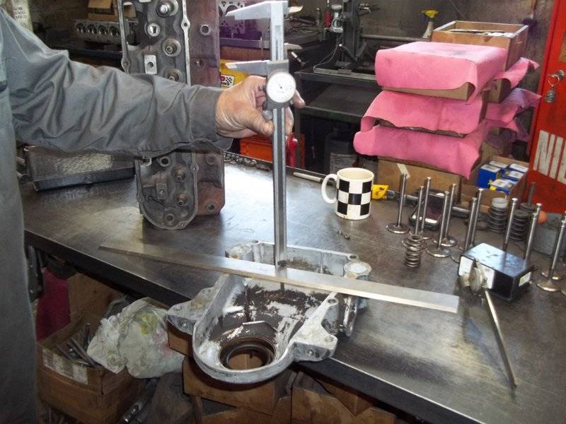

Does he have to use the LA timing cover to have room for the longer snout?
I had to run .050 Cometic head gaskets for clerence of the LA pistons coming out of the hole. On the Magnum block I'm looking at a .028 gasket to gain some compression over the stock mag compression. That .~020 difference my call for a different pushrod length. We'll see.... I plan on running an LA front end, timing g chain cover etc.. I will need a different balancer.
I am running Crane 1.6 roller rockers.
He shouldn't. I measured a Magnum TC cover and an LA one years ago and I didn't get any difference in the depth and I didn't see anything that would interfere.
I've got a Magnum TC cover loose (and for sale here) so I could snap a picture if anyone was curious.
Edit - not that it matters since the OP isn't running a Magnum TC cover. :lol:

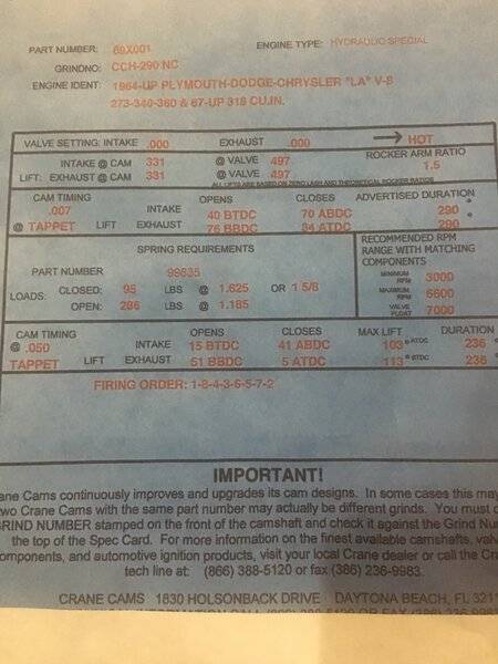

I happen to have a NOS Crane Hyd I picked up here years ago and now is the time. The 5.9 is a stock long block. It has a Chink intake, 750 AFB, Summit Racing 1-5/8 headers into there X pipe and will use there turbo mufflers all @ 2-1/2 ending at the axle for now. The cam is one of Crane’s special cams I think we’re designed for bracket racing with these specs.
@.050-236/236-.497/.497-108 The amount of overlap at this moment escapees me. I’ll have to check the cam card and see if it’s listed.
I think the compression is a little light, and the 108 could be moved down to a 106 for as it sits now, but it’ll be OK. A 2.02 valve would be better. Ether way, bracket engine or street engine, this will be a good cam and a reasonable package to enjoy while I put together the bracket engine for the Duster.
A bunch of Cranes cams were lift limited for some reason as if the cylinder heads could not be ported.
Do you know all of your cam specs by chance?
I found the cam card within my phone pictured below.
No overlap information provided on the card. I like to know this value myself as it’s something I’m used to dealing with on older cams and their information provided by the grinder. It’s useful for me. I’m sure somebody here could figure it out.
LOL! I’d bet, if AJ/FormS seen it and took the time he could tell me! He likes numbers & calculators.
Yes, I have my cam specs.
