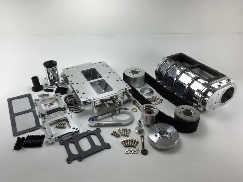

You may need it if you have one of these on it...
