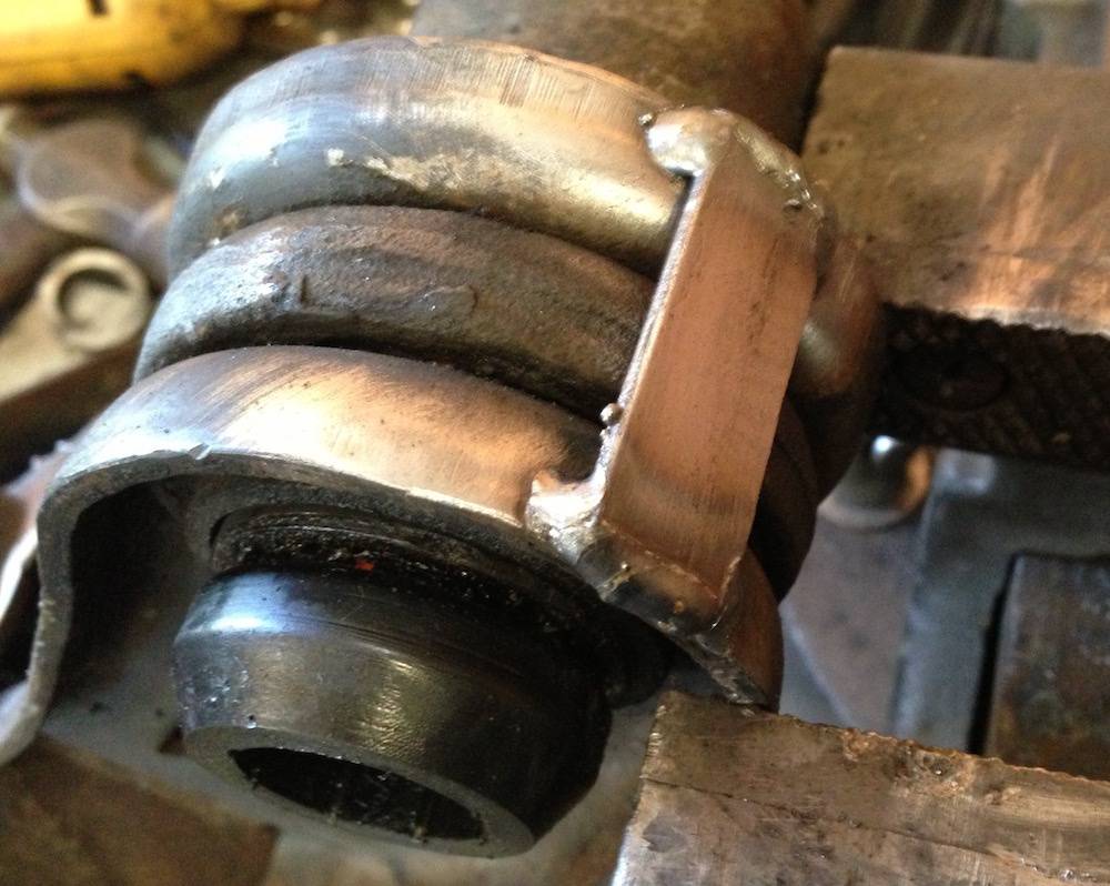

Rebuilding my front suspension--here's the lower control arm. Should it wiggle like this?
They loosen up like that over time. What you can do is put it in a vice and tighten it up so the wiggle is gone but make sure it still pivots. Then weld a strap connecting the two outer halves together to get rid of the slop. You can also run a piece of sheet metal across the whole bottom or buy those stiffening plates they sell. Hope this makes sense. I believe Jim Lusk has a video of this on youtube.
Mopowers beat me to it. No, it shouldn't wiggle like that, and the video by Jim Lusk is exactly what you need to do in order to fix it. In addition to the stiffening plates on the bottom I also add a "strap" across the ends, to control the LCA right where the pivot is. Just make sure it's out of the way of the lever on the pivot. Hopefully you're already planning on installing new LCA bushings as well.
From a different angle. Also shows the gusset I add to the pivot tubes in the K member.
Hey blu that looks like a Delrin bushing you got there
