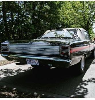

I bought this kit. I use 1 for clear only and the other for base coat. Little gun works good too. Aluminium cups not plastic is a big plus when it comes to cleanup. Painted both of minee in garage with this kit.

Not that I know anything specific, but it seems the thing to want is something with good atomization and a nice wide spray pattern. Obviously they seem to work well based on your cars (awesome btw). How big of a deal to get parts for them is it?
