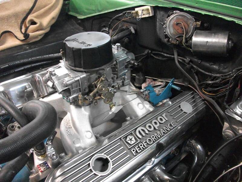

Air Gap..I'll use the stock one then. Just took the throttle cable holder off of the old 318 and will clean it up and paint it.

That looks fine. My throttle cable is bran new so let's hope it works but with this new stuff now a days nothing seems to fit right :lol:

All in the car now and everything works good..The old bracket looks a little barn yard but it works and the gross old wiring has been taken care of too :lol:Thanks everybody
