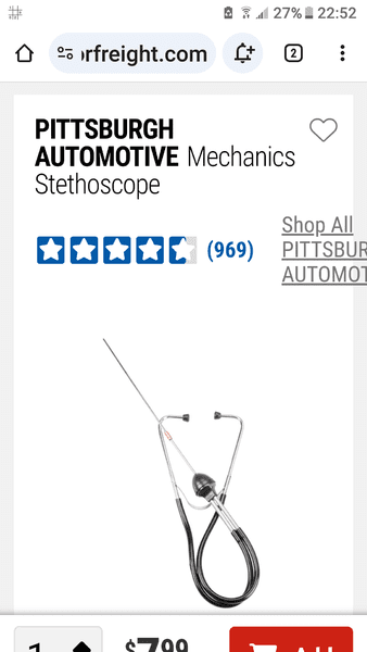

Put this on your mechanical fuel pump area and listen for the arm to jump off the actuator lobe attached to your cam.
Stethoscope is good. A long piece of heater hose also works by moving one end around the engine and the other end in your ear.
