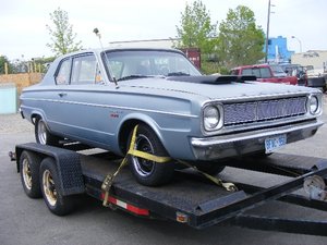

Hi,
I have a 67 Valiant 100 on its way (I hope!) and lookin for inspiration....
Want to go Old Skool Gasser with this - has anyone any pics of a similar machine for inspiration?
TIA

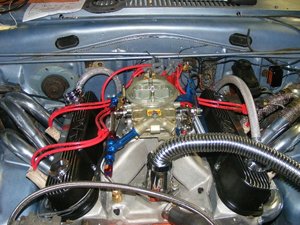

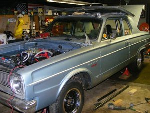

Here is my '64 Valiant... It is a V8 auto, bucket seat, power steering car...I almost hated to cut it up...almost! It's still a work in progress.
It has Super Stock springs, a '57 Ford 9-inch, a Speedway 4-inch dropped straight axle kit...It's getting a 360/727.

Hey DV8, you got a pretty cool project there!! Have you connected it up to the steering box yet? Looks like the 4" dropped axle is about right. Can you give us some more pics of the axle installation? Also how about some current pics of your buddys car.

Thanks Mike!
The drag link is connected to the box (I had a power box, but converted to manual), but with the dropped axle, it is going to bottom out on other suspension parts. The 4" does look right when finished...much more streetable...but a non-dropped axle would have been easier with the stock pitman arm.
It's at my buddy's shop, and it's stalled until my oil pan comes in, but we are going to try to get around the clearance problem and stick with the dropped axle.

Are you going to a rear sump or does the pan have to be custom made?
Thanks,
Mike
No, it has a rear sump...it's from a truck. I ordered a Milodon street/strip, center sump but I guess it was back ordered.
We trimmed the K-member here and there to get the spring mounts as far back as possible, so everything to do with the engine mounting will be in the stock location, I just wanted a deeper pan, and needed the car pan instead of truck.

DV8 -
Which oil pan works best with your axle set up?
Rear or middle sump?
Thanks,
Mike
Middle...The rear sump will obstruct the steering draglink.
I ordered one from Summit. Maybe it will show up!
