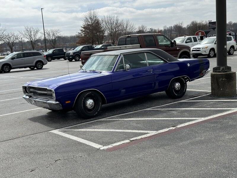

I rebuilt my front suspension like 4.5 years ago… eyeballed the alignment… pulled a touch to the right for a bit… eyeballed it a little to the left and left it. Wheels look pretty straight…
Drives fairly straight now. Keep saying I should get an alignment but…. It drives fairly straight now and I’d have to make an appointment to get an alignment and then… I come back to the conclusion that it drives fairly straight now.
I also drive the piss out of it.
